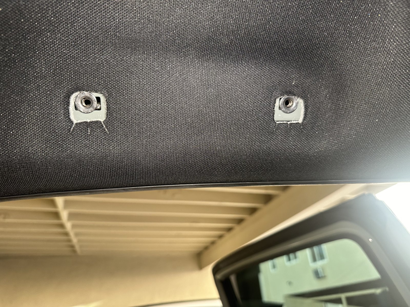

    Update: Emailed Meso Custom. No prediction on when the handle kit will be available. It's extinct.
    My solution is pictured. That flimsey clip thing Toyota made for the handle seemed like a terrible idea not at all worth repeating. (Some terrible ideas are worth repeating; not this...) No. So, some caliper measuring and scouring Amazon for spacers, with result: I bolted it up there using M6 bolts. Quite secure. The crux of it was the fact that the panel mounting bracket uses a stepped-down rectangular opening at 32×34 MM inside dimensions. The square aluminum washer you see here is 32x32x2MM (designed for solar panels). Works perfectly. If anyone wants the parts breakdown, I can post that on request. Amazon hardware ocean. I may add an oh-$hit handle made out of 550 cord. TBD. Also good news, I spoke with Alec at Mojave Manufacturing. I sent him the specs and he's now making MOLLE backers for this HOOKE panel as a stocked item. (He did not charge me for a custom job.) I don't have the backers in hand yet so I can't report on how they work.

    Hi there. So here's what I used:
    M6 steel jack nuts to anchor the M6 bolt. (1 per hole)
    1/4" ID x 1" OD steel washer (2 per hole)
    M6 x 25mm - socket hex bolts (one per hole)
    M6 ID x 18mm OD - coned countersunk aluminum washer (one per hole)
    M6 ID x 15mm OD x 2mm thick aluminum standoff spacer (one per hole; the red thing in the photo, THIS fits inside the 5/8" hole in the square washer to act as a reducer. I could not find square washers with a 1/4" hole.)
    1-1/4"(32 mm) x 3mm thick x 15.8mm ID center hole, Aluminum Flat Plate Square Washer for Solar Panel Mounting Clamp (1 per hole) Here's the link:
    https://www.amazon.com/dp/B0D21TV2PS?ref=ppx_yo2ov_dt_b_fed_asin_title
    Note: the jack nuts I found on Amazon came with an installer tool - simply a threaded puller but works better than just using your mounting bolt to compress the thing. Someone else here mentioned having to Dremel the jack nuts to get them through that rectangular opening in the truck wall BUT, I did not need to do this. I put a bolt in the jack nut, held it with a Vice-Grip, and just worked it through there; took some force but not enough to deform anything. Using my photo, it should obvious how to stack all that crap together. Definitely secure.
