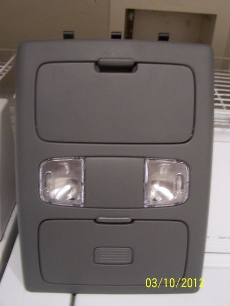

    I have a 2008 Prerunner, with an overhead console in plain grey like the one pictured below.
    I have seen pictures of them with digital read out on them. Temperature? Compass, maybe?
    Is it possible to install one in my truck without having it come from the factory that way?

    Yes, it is possible.
    First off you need to get an Overhead Console with the Temperature and Compass capability that is compatible with your truck year.
    (If I can remember correctly, I believe that the Overhead Console will fit-interchangeable, any where from the years 2005 up to 2008?
    I could be wrong so double check this.).
    Once you have one then the next step is to check to see if your truck already has the connection for the "Outside Temperature Sensor" located between the front grill (look behind the mess grill located on the frame bracket) and the radiator (in front of the radiator) of your truck? If the Outside Temperature Sensor, or at least the harness wire connector is at least there then that's one less step that you have to deal with. If one or both are there then your in luck but if not then no problem you can install one (or both) like I did.
    The connector for the Overhead Console will (should) be there and can be seen once the original Overhead Console is removed.
    Follow this thread it's a "big help", believe me: https://www.tacomaworld.com/threads/ambient-temperature-gauge-and-sensor-install.39264/#post-9184166
    Here's another: https://www.tacomaworld.com/threads/overhead-compass-temp-fix.18497/page-42
    Keep searching here on the forum, there are other post/threads concerning this subject.
    Don't give up you can do it.
    Good Luck!
