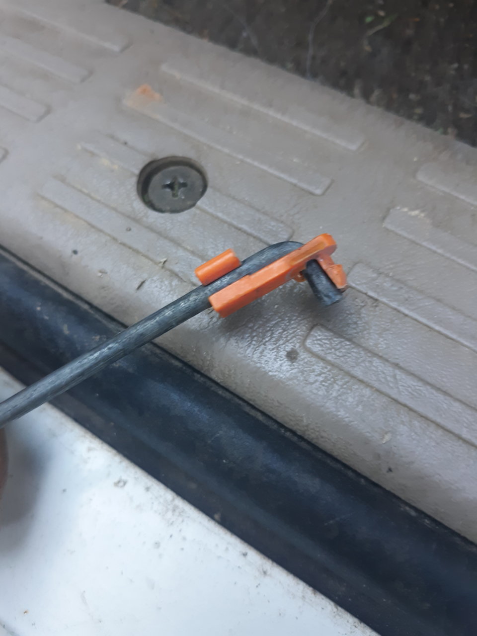

    Where can I find one of these

    The rod or the plastic clip thing? The plastic clips things come with new door handles, so if that's all you need you could buy a cheep aftermarket door handle and just take if off that. I don't think you can get only that part from Toyota, but I could be wrong.

    The plastic part. When I order the new handle I didn't see anything to do with it

    I bought these a few years ago and they came with that part.
