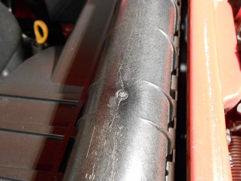

    It seems the OE Harrison radiators had some quality control issues. This, along with some other parts made by GM subsidiaries as OE for the 1st gens, like the washer fluid tanks.
    These are shots of what look to be hairline cracks. They are actually spots where the liquid plastic flowing into the mold came together. Was the injection mold or the plastic itself not hot enough, was the tank removed from the mold before totally solidified, are they cracks subsequently filled in after the fact? Some of them show evidence of being ground down. Hard to tell.
    I noticed the "lines" on day one but the dealer refused to do anything about it unless it leaked.
    The radiator is still like new inside and out 17 years and 250K later.

    Yep, makes sense Dirty. That's exactly where my leak was. I thought reckless weight placement from an owner or a tech could've been the fault. Now I see what you're saying and very well could be the plastic is weaker there at that interface

    I had my previous radiator last to about 259,000 miles and it started leaking with cracks to the plastic upper area of the radiator. It was leaking on the ground and I couldn't find where the leak was. I was inspecting the radiator hoses, squeezed the upper radiator hose and coolant squirt out on me from the upper radiator area. I tried to put marine epoxy on the leaks. That didn't work at all.
    The leaks were similiar to the pictures on post #6 on this thread. I had my mechanic install it since I was in a rush and didn't have a ride to get parts, if I bought the wrong radiator.
