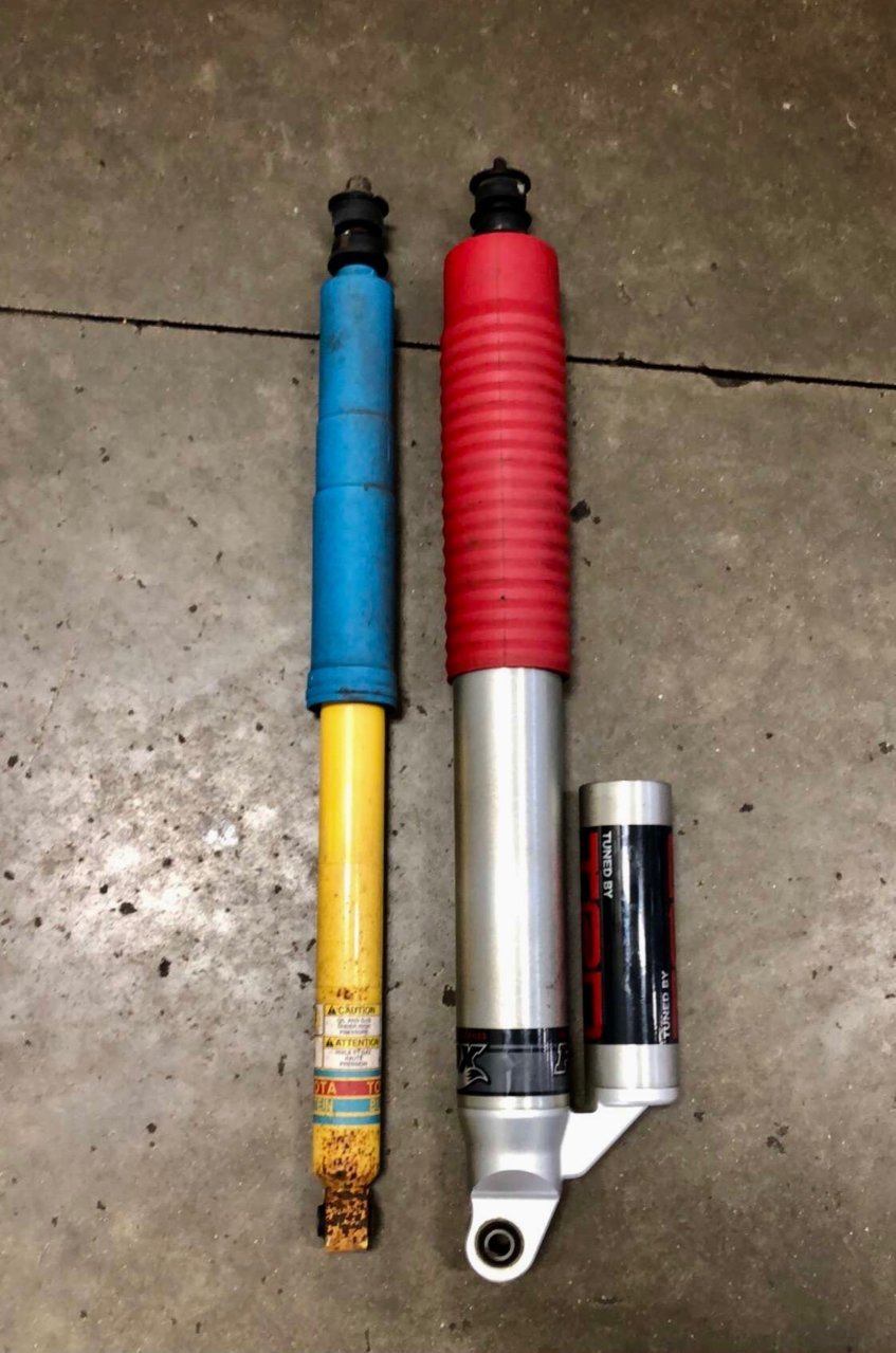

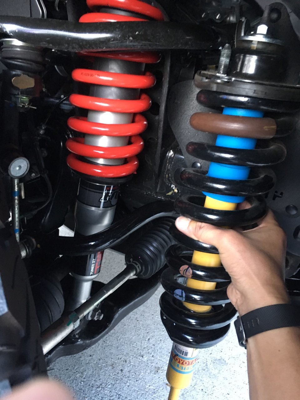

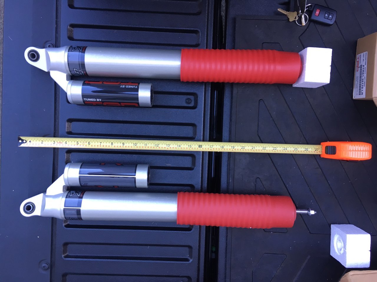

    So I was looking for a suspension upgrade for my OR. My requirements were to level truck, be rebuildable, hold up to Midwest winters & under $1,500. Short list was either Fox stage 2, 6112/5160's or take offs from a TRD Pro. I rode in a 6112/5160 equipped Tacoma & was not to my liking. Last week I was able to buy used TRD Pro Fox shocks from a member of this site. During the install today I took a few pictures of the size comparison to the OR shocks. Pretty funny. Install took no time. Did a alignment afterwards & got great numbers. 2 degrees of caster was no problem. I did a before & after ride height measurement as well. Gained a inch of height up front. Drove about 50 miles so far with mixed roads. First thing noticed is the brake dive is greatly reduced from the OR setup. The compression & rebound seem much more controlled as well. Overall very pleased with the purchase. IMG_0039.jpgIMG_0038.jpg

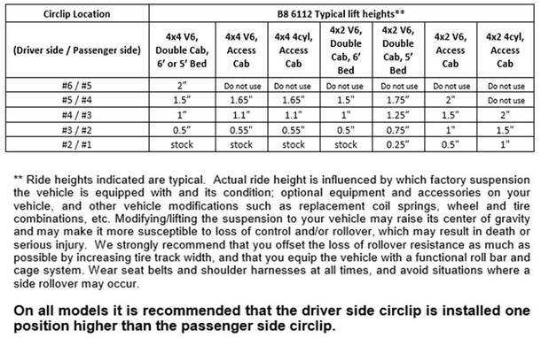

    How much preload were on the front coils with the 6112's

    Enough to raise it 2 inches up front.

    Ok, so that's the most lift you can get out of them from what I'm aware. The fact that you said they have a harsher ride to the Pro shocks is more to do with that than the shocks themselves I would think.

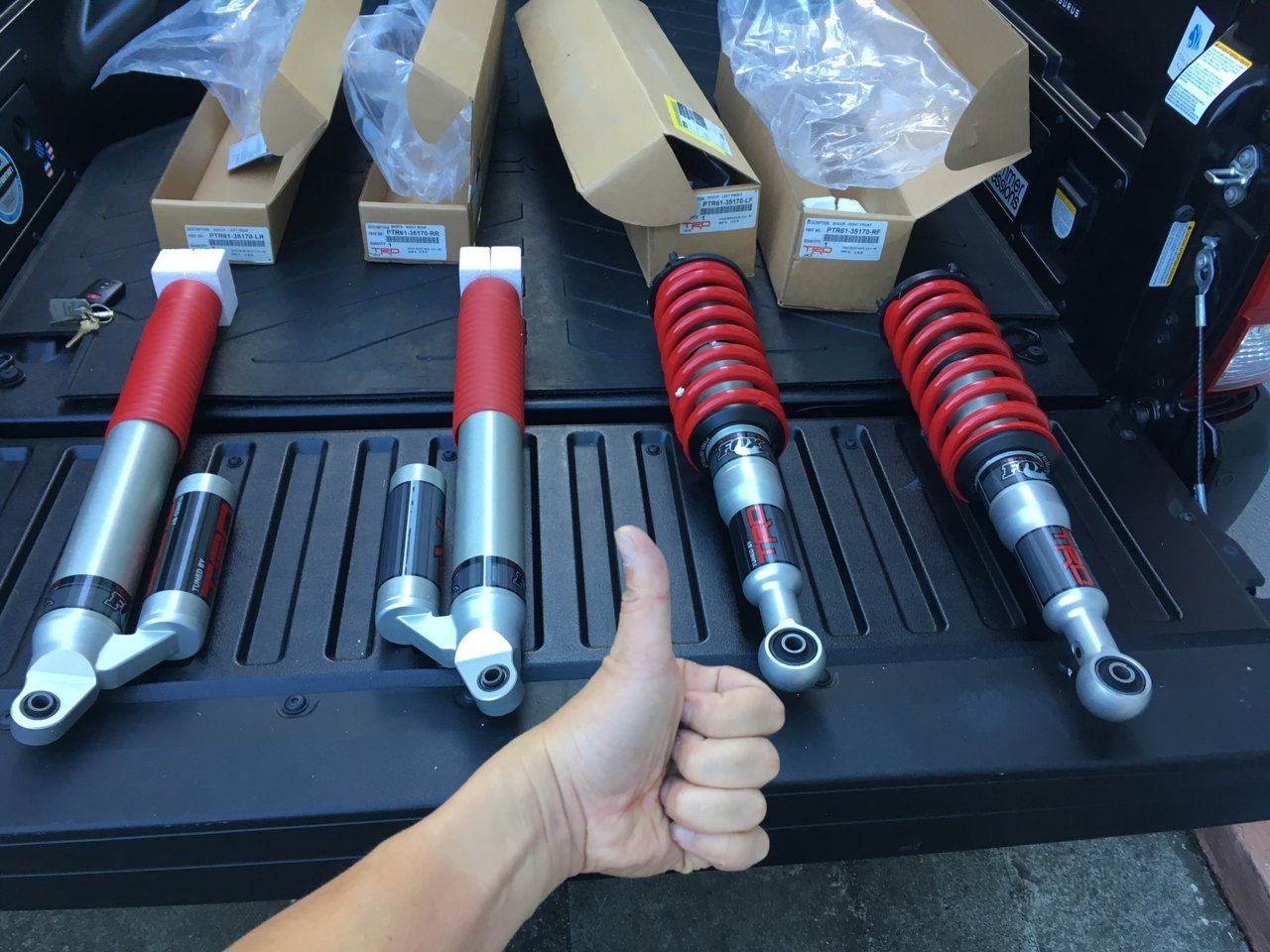

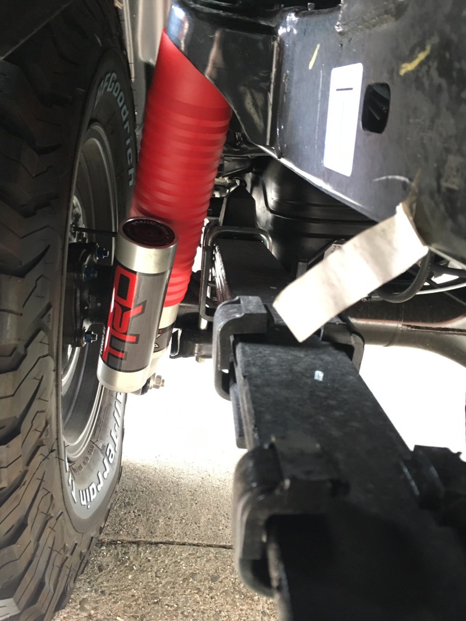

    20BB07C2-2EB3-438F-96E6-2D2582474114.jpg A0A84946-AC97-4F82-9FE9-5CAB03531202.jpg FA342946-3725-41BF-A271-E376BD7C6CA3.jpg 2E950993-E3F8-4BEC-8C3E-D54B7D02E0FD.jpg
    Glad I made the switch as well, yes they ride better than the OEM Bilsteins.
