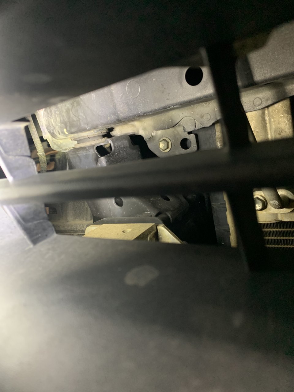

    I’m going to attempt to add pictures to this post.
    I get random squeaks over speed bumps and like quick elevation changes in the road. Like down hill to a flat bridge or dropping down into a parking lot. It’s a weird creak and thought it was springs till I researched some.
    my radiator support bushings do not look the same from right to left sides.
    I assume one is bad and that’s my creak
    sorry one picture is a little blurry from my hands being numb in indiana

    Those are not the radiator support bushings they are the front cab mounts. Those are known to crumble and cause noise and squeaks, replace with poly.

    I always called them body mounts too and saw people calling them radiator bushings when I was researching
    is there a way to tell if they’re bad. I have jumped up and down on my truck everywhere and can’t get it to make a noise. Take it for a drive down to the bridge…squeak!

    you can unbolt and move them one at a time and assess the condition of the rubber. Think they are a 14mm. Place jack with a piece of wood to hold up that side of the truck.
    the radiator support bushings are 4 horizontal mounted bushings that bolt to the core support, those are also known to crumble over time. What year is your truck?

    Body mounts on my 15 with 85k were all chewed up. They looked fine from the outside, had to jack up the cab and expose the top to see the deterioration

    I replaced mine w/ about 100k more than you and really didn't notice a difference. I was bored during the lockdown years so replaced as much as I could for something to do. They don't seem to be giving you an issue so I'd probably skip it if I were you.
