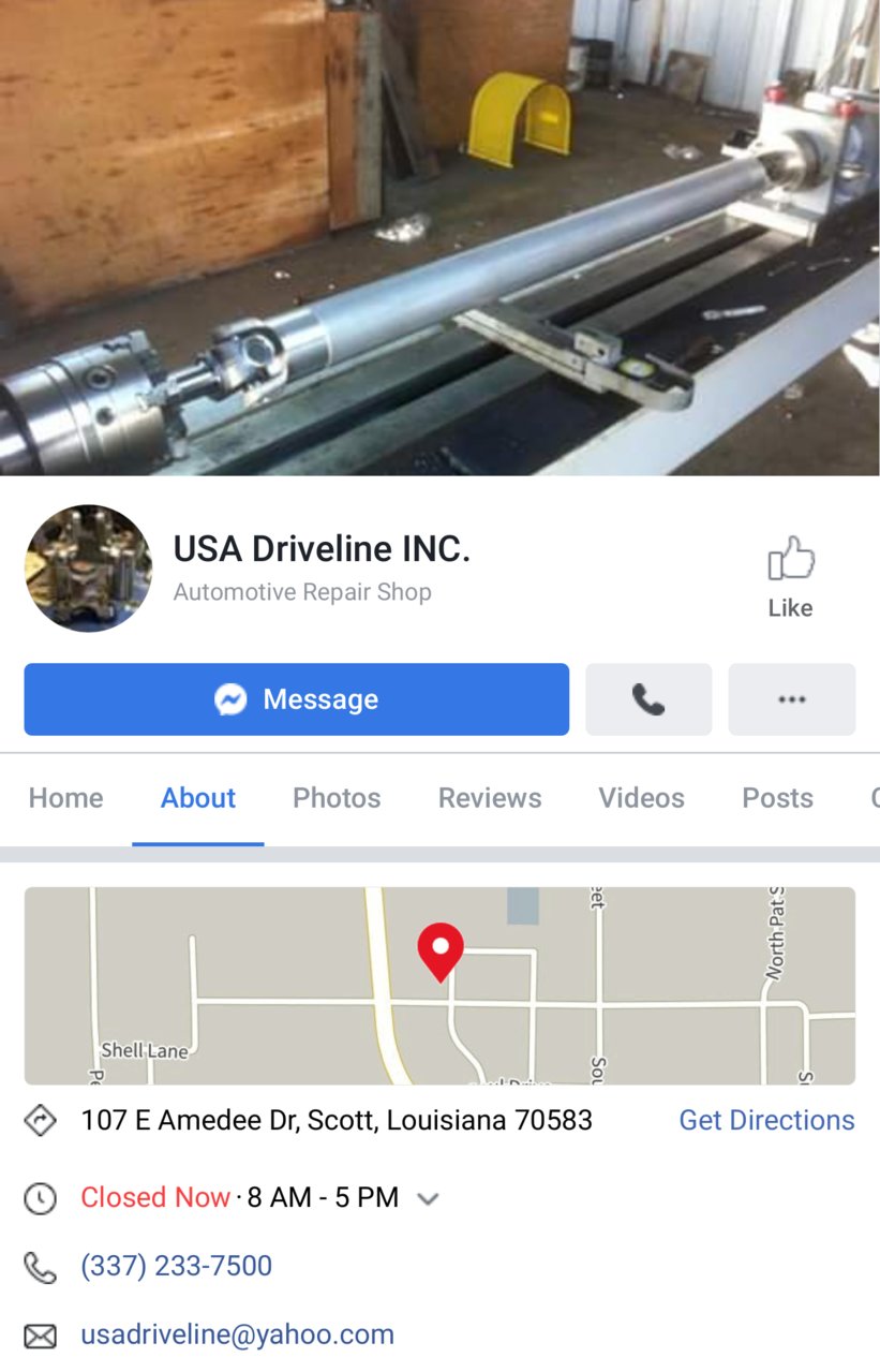

    I'm Prerunner, not 4WD, but after going from 3" to 7" lift nothing stopped the vibrations It was bad!!!! Rene at USADriveline did mine, he does a lot of Tacoma's. It's a 4" aluminum, been about a year and a half, not a single vibration. Save yourself some time, money and headache and just bite the bullet and fix it right and be done with it. I wish I would have done it years ago.
