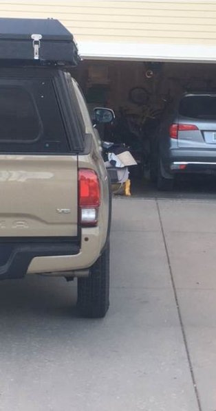

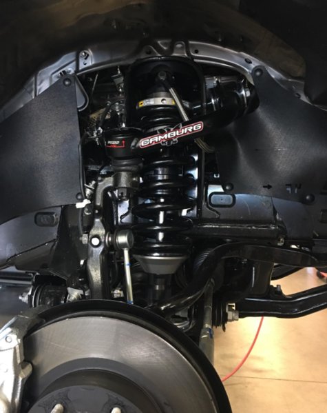

    Well here's a picture of the front. The reservoir is hiding behind that black dirt guard? (apron? not sure what to call that thing) someone has pointed out I should pull it out for heat and I agree---I'm going to move it back to the outside.
    I love the tall skinny look and putting on some spacers to see if I can get a little bit of my man card back on these skinny tires ;). People at work are calling them girlie tires, Bicycle tires, etc. They just don't understand my Pizza cutter/ military ways ;)
    I'm looking for best snow and mpg so that's my reasoning. Thinking of going summer set TRD wheels like yours and considering 33"s ---I was going to go Cooper Maxx but some of the info here has me re-thinking them vs the KO2's.

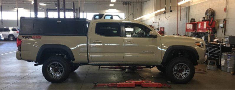

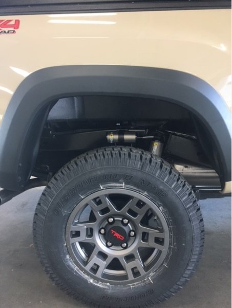

    235 stance from the rear
    These are 32" tires with the full Dakar pack as it comes with BP-51 kit, no AAL or overllads added. My shell is about 160lbs.
    Sorry I can't tell you want the gain in inches was but about 2-2.5 Is my guess.
    The front CO's are set to 10mm as recommended by OME since I have no bumpers

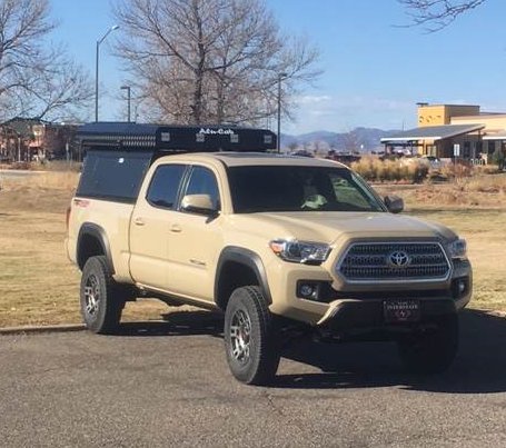

    Here it is right after install not even driven yet. Sitting a little higher than it looks now further below.
    When I checked it after a few miles it had exactly 1" rake :)
    Here with the RTT on it's a little less than 1" rake and I'm sure there is settling going on too.
