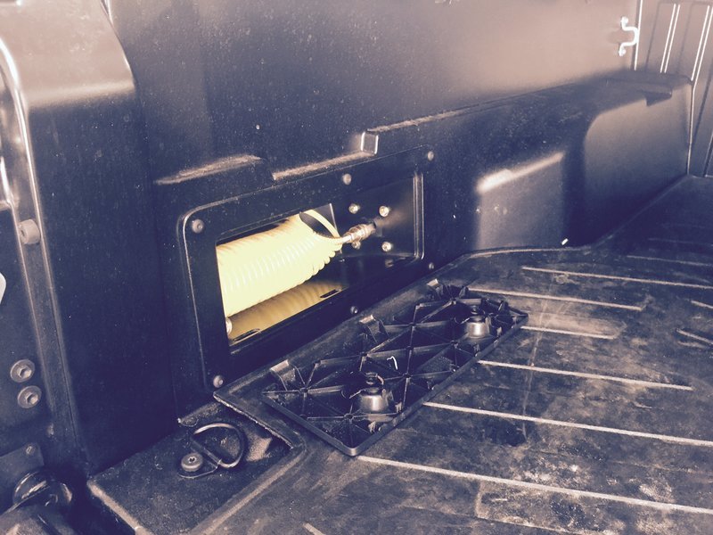

    My Arb twin comp is in the hood, rear right side of the engine and the air port is located in the bed in the left cubby.

    2017 White Tacoma SR AC 4cyl M/T
    How'd you power that up and mount it. That looks ideal.
