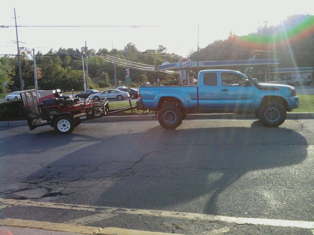

    dirty truck mod, custom trailer scratch on tailgate, husky floorliners, OME Lift
    :eek: I think you may need to invest in a drop hitch.........
