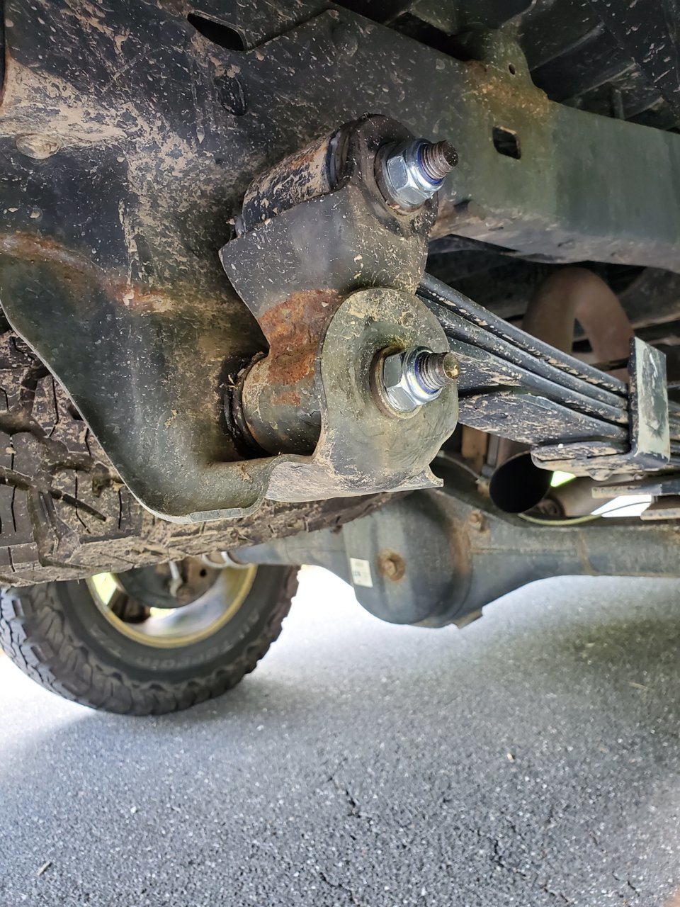

    I also used a trick that @GHOST SHIP taught us......switch out the nuts on all of your bolts to the shackles and the front of the leaf to nylon lock nuts and torque to 50 ft lbs instead of 87 ft lbs. Gives more articulation and less bushing binding. They are M14 x 1.5. I got some from Fastenal. Btw, do you have a ubolt flip kit?

    No negatives found as of yet and I’ve been running my rear hardware like that for over a year.
    Although, Without using nylocks you run the risk of the nut backing out. Prior to getting nylocks, I used blue loctite and didn’t have any issues. Also if you are going to use nylocks, make sure to run them down manually. If you use air or electric impacts, the heat generated from the nut spinning fast will melt the nylon insert thus rendering the “nylock” useless.
    I’ve done enough installs and found a lot of people tend to overtorque the rear suspension bolts/nuts. You’re robbing yourself of rear travel just by over torquing. I talk about it briefly in my Dakar Bushing thread.

    I love the way the truck moves now. No issues and no "w"ing of the leaf pack anymore. The nuts haven't moved a bit and it can save on the bushings.
    Definitely did it by hand.......and btw .....YOU ARE THE MAN!
