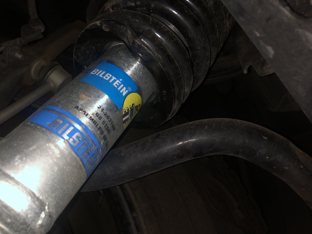

    also what notch did you put the blisteins on?

    Check send pic of the shocks underneath the front

    I don’t really know what I’m taking a picture of but here you go
