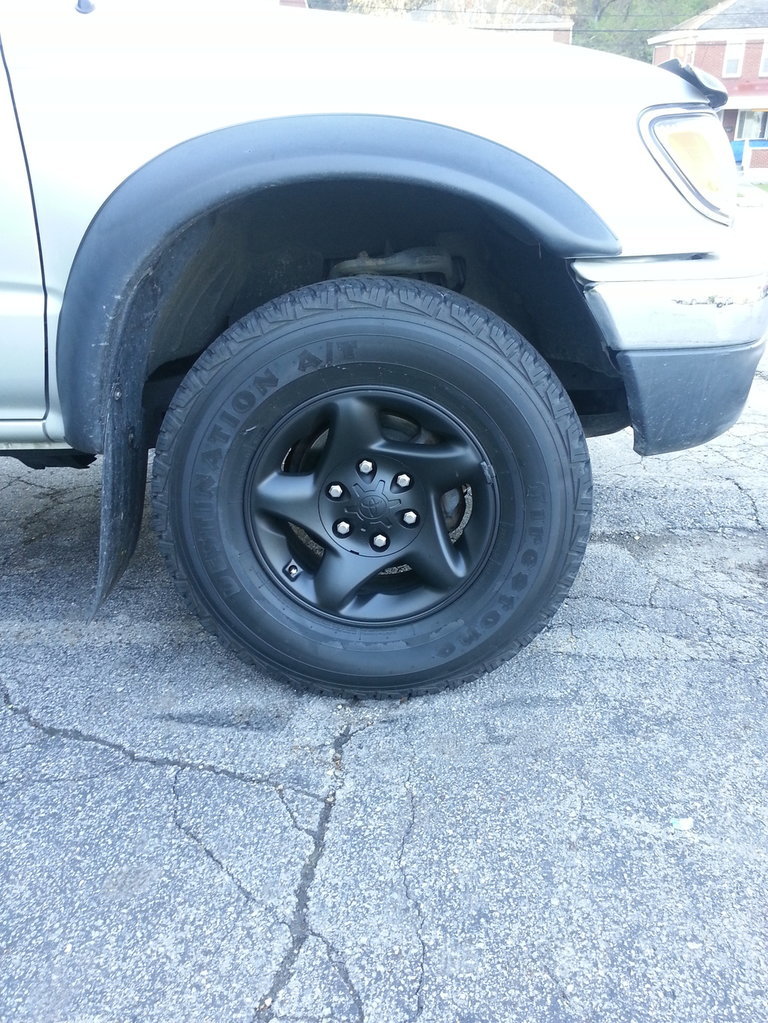

    Picked up these wheels (17") and had every intention of using them but they are way to big and heavy. I sold them for what I paid... oh well. 15" or 16" will be better.

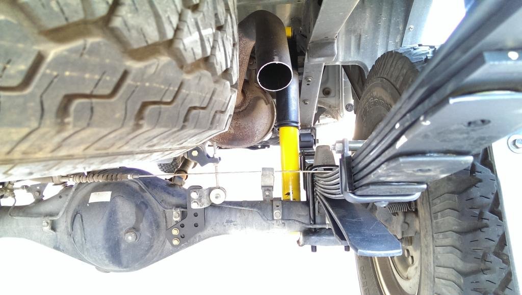

    I have seen where the OME Dakars would require you to get that out of the way.... They make a "relocation bracket" or I've seen where others have just cut them off.
    https://www.youtube.com/watch?v=qjPmK6LkLTI

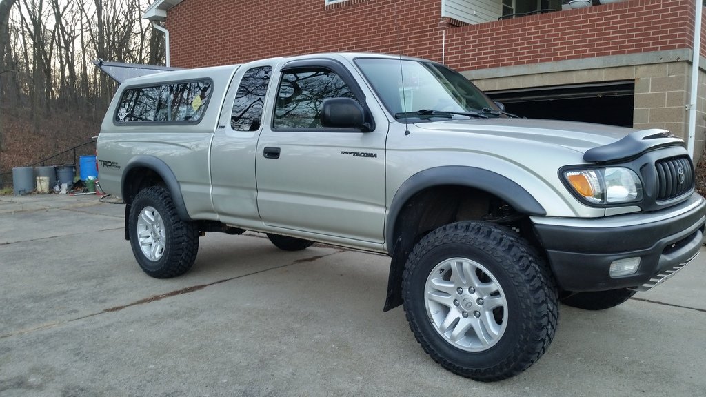

    saw this post.
    https://www.tacomaworld.com/threads/2-7-header-decisions.361562/
    also I'd wait and get the skinnies.
    super skinny (9.25" wide) is the 235/80-17
    regular skinny (10") is the 255/75-17.
    with mine I do notice the difference in under-steer(I think) with the slightly taller/skinnier tire but the rims/tire combo I have looks like it pushed them out a bit.

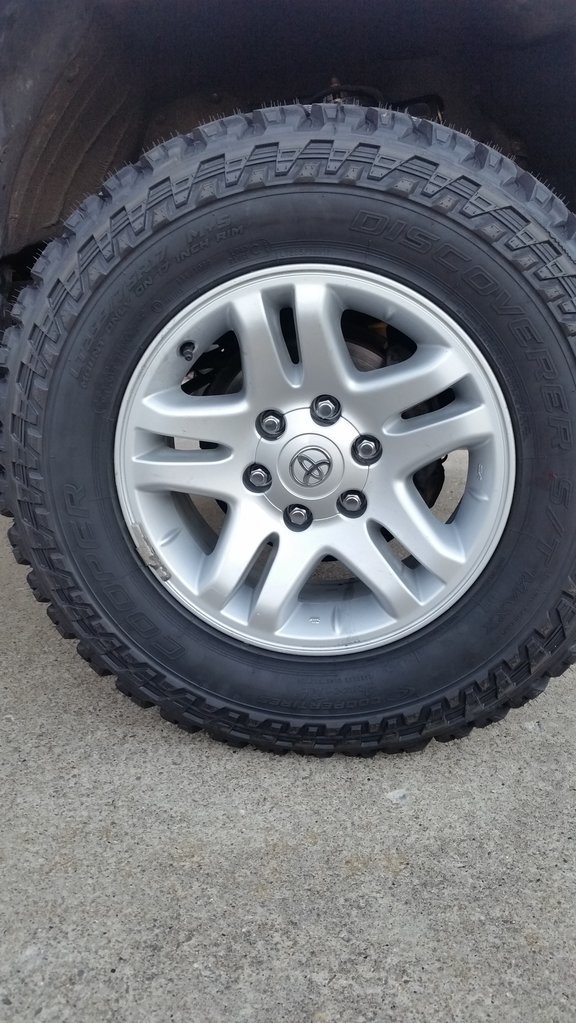

    Frizzman - I really like those skinnys... How are the coopers working out so far. Road noise, grip, wear, etc..? I like the size and fit.

    fit is good. rubs at full turn but not on the UCA. I drove up my street in 2wd yesterday without any slipping so they are already good.
    road noise is about the same as my previous Cooper M/S Studded. definitely less than a M/T but louder than the A/T Firestone's I had. I can "hear" them but got used to them already. being a little taller and a little skinnier the steering feel is different (lift helps move up the COG too). slow rolling you can feel that they have lugs tho :)
