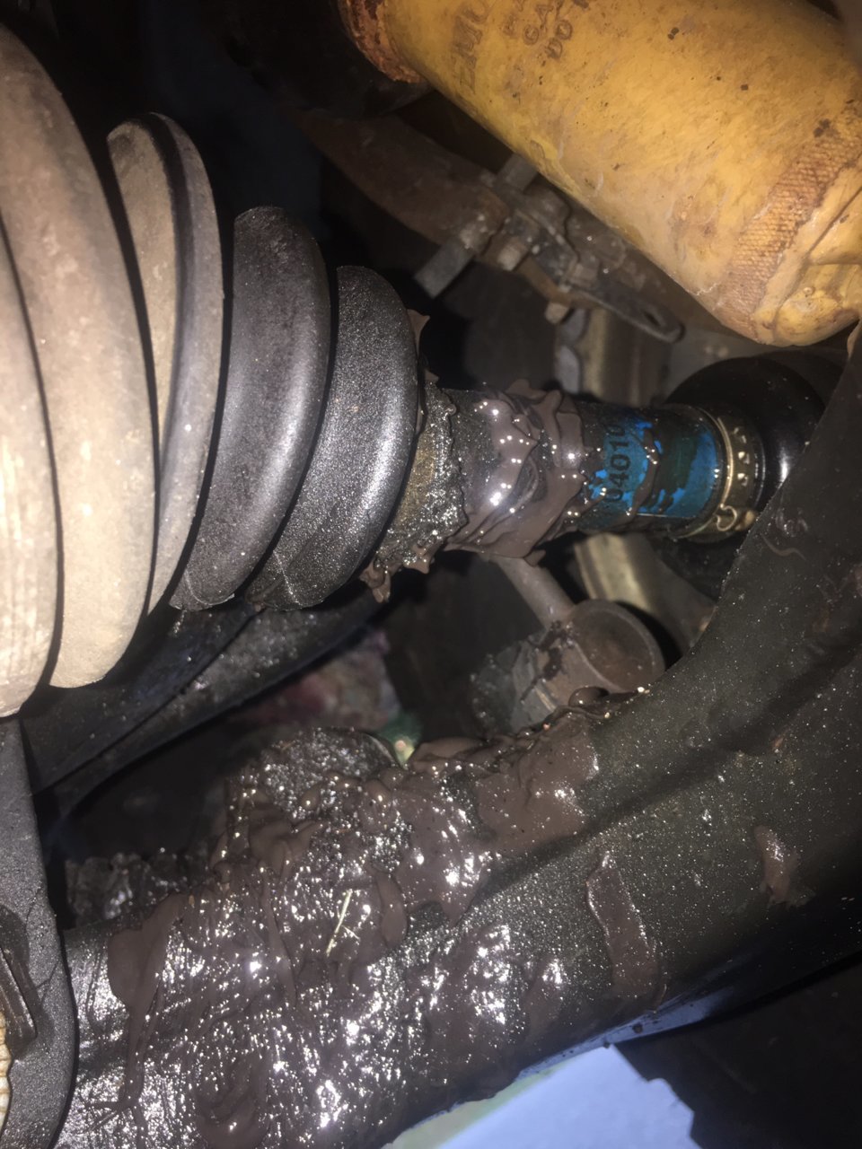

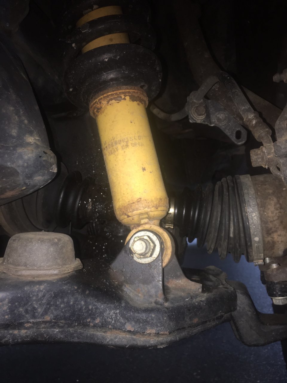

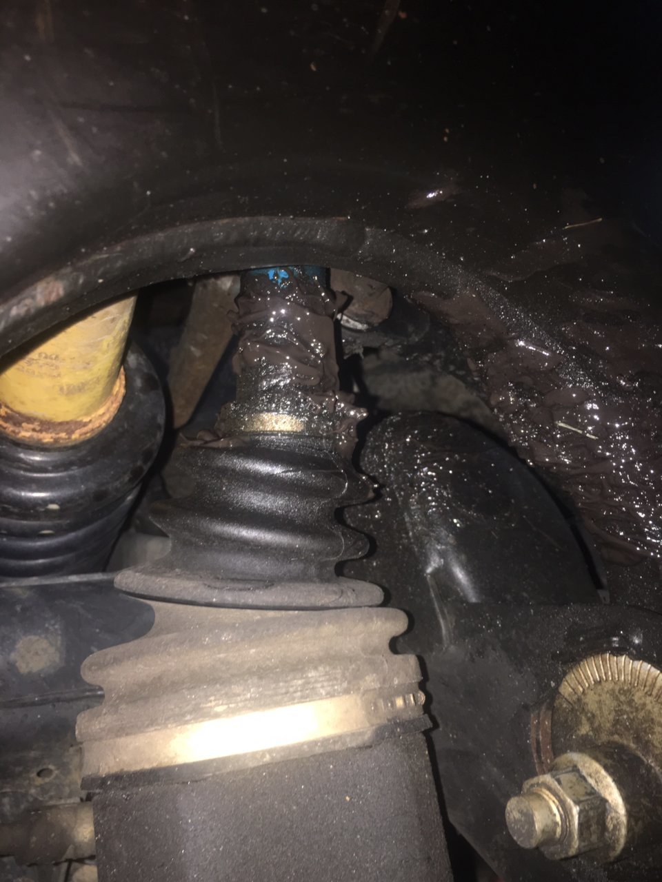

    I still question the effort to reseal the oil pan gasket right now. I have bigger fish to fry... The next things are:
    - replacing the axle boots (leaking/ torn throwing grease everywhere)
    - repacking the hubs
    - changing rear diff oil, changing front diff oil, maybe change transfer case oil
    My paint is slowly worsening. The hood is peeling like crazy now. Not sure what to do to stop it. Also, my valve cover paint job has chipped away. Nice while it lasted... I did not prime properly.IMG_3663.jpgIMG_3666.jpgIMG_3656.jpgIMG_3664.jpg

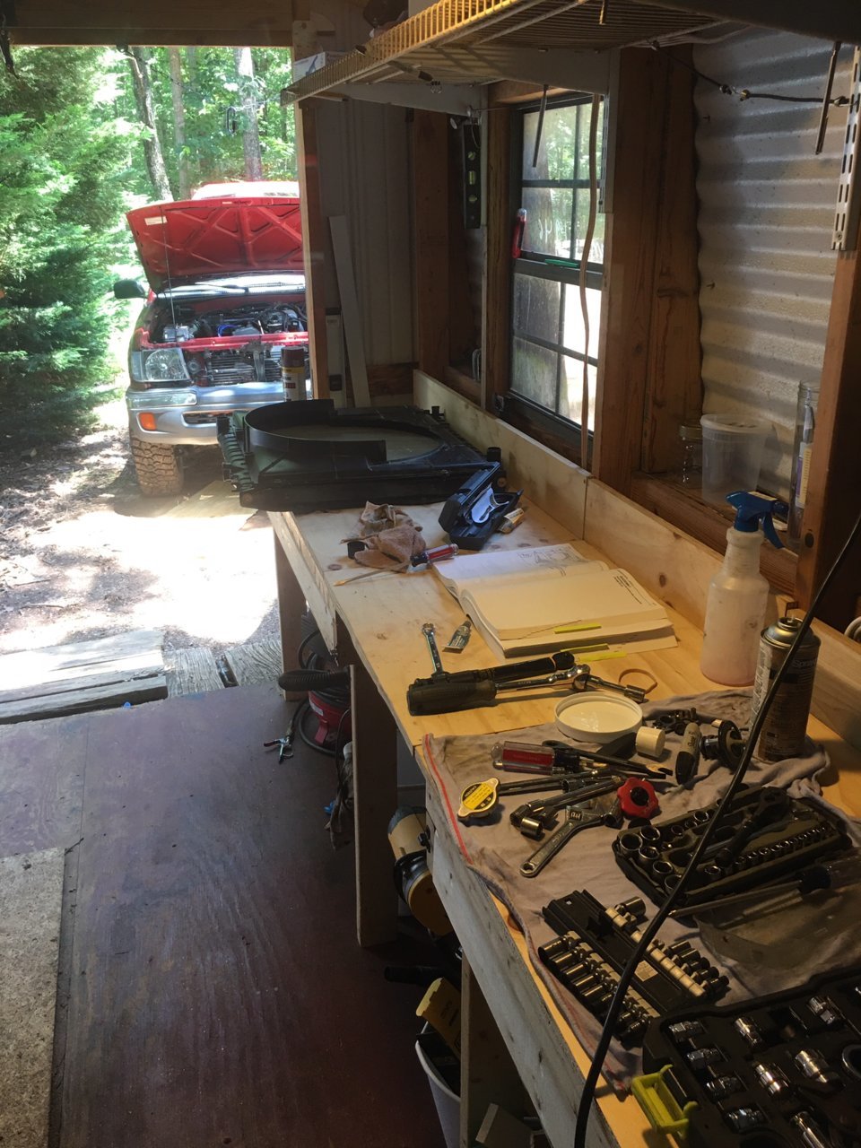

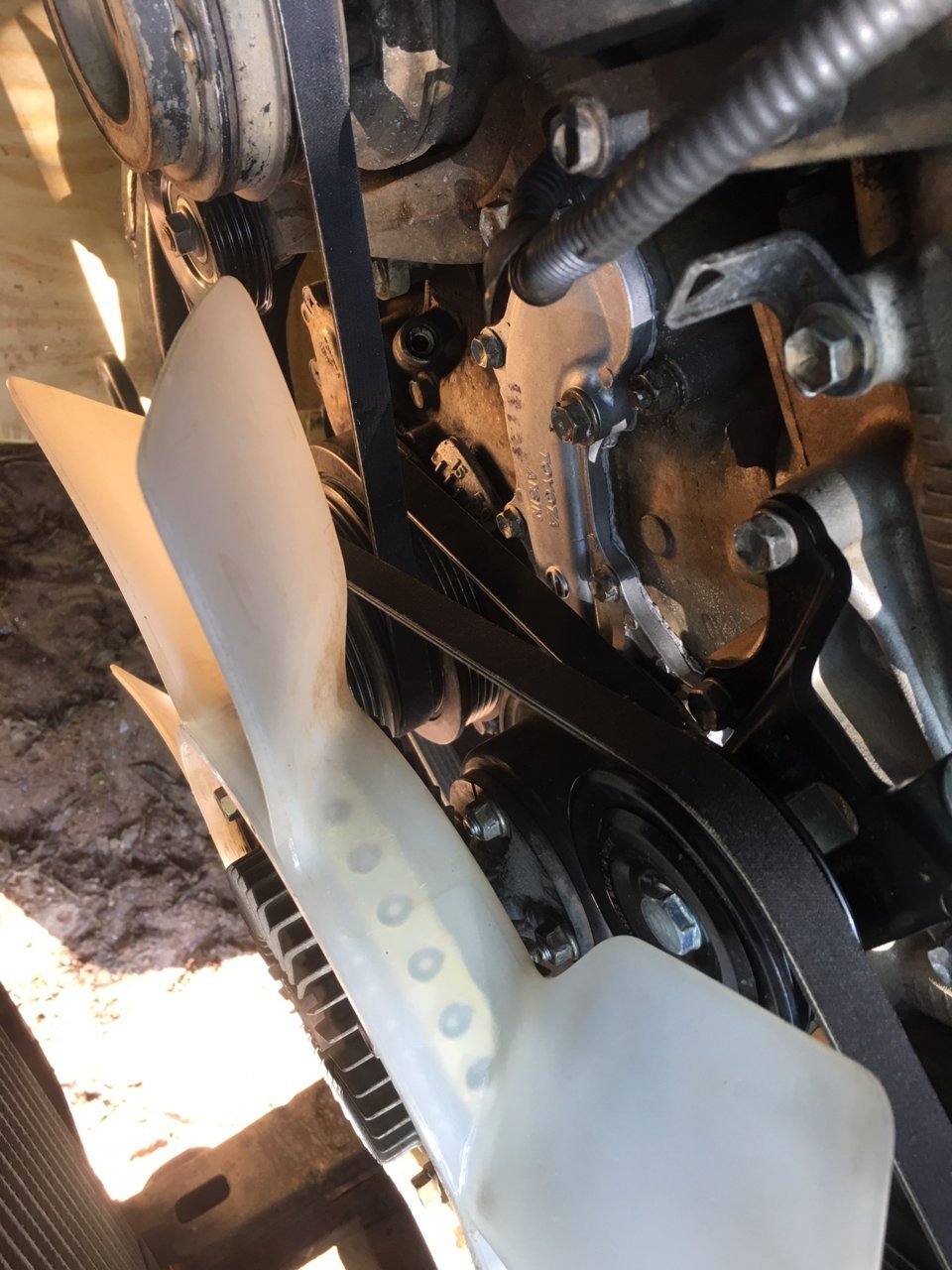

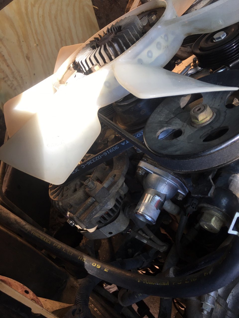

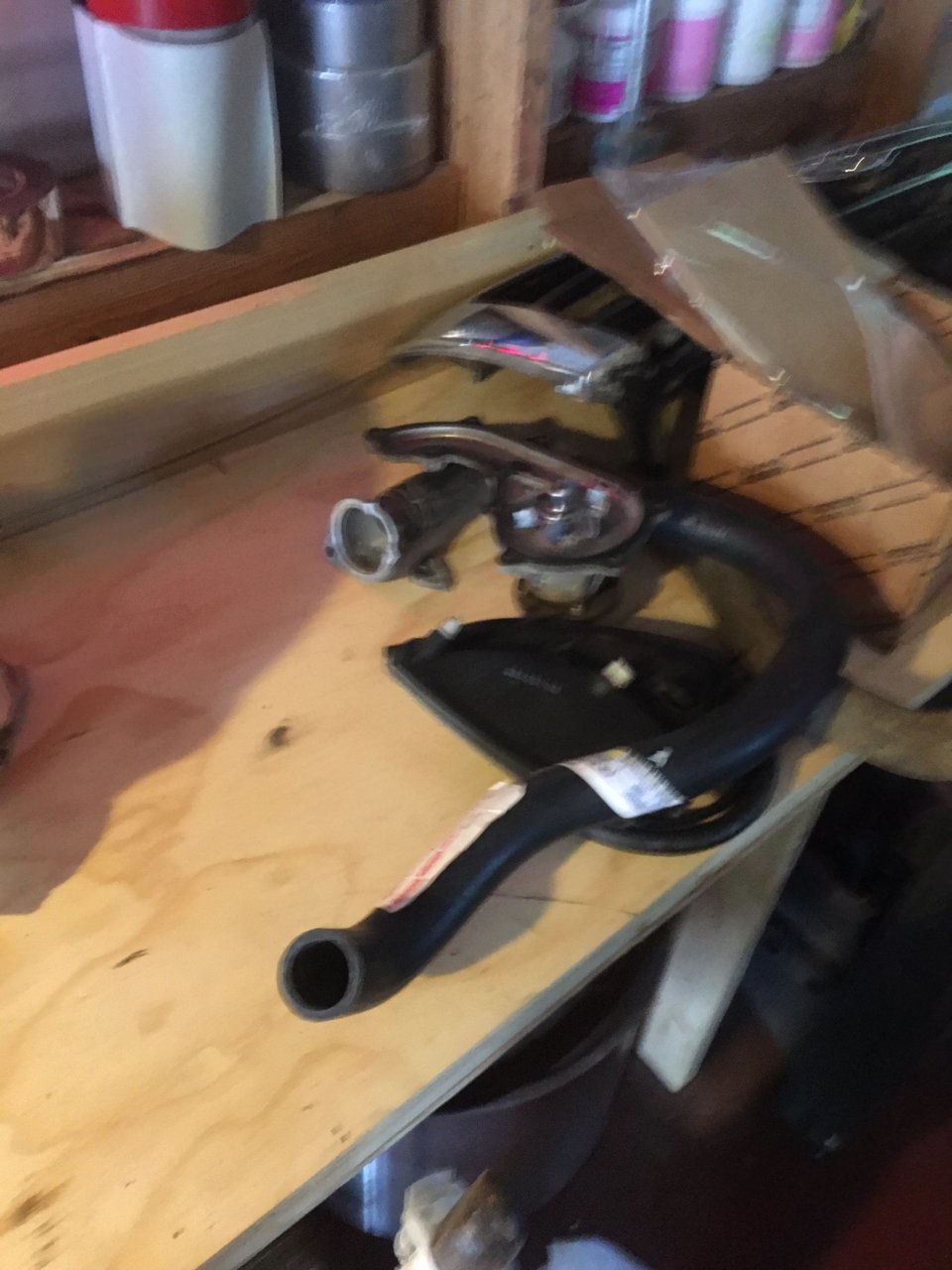

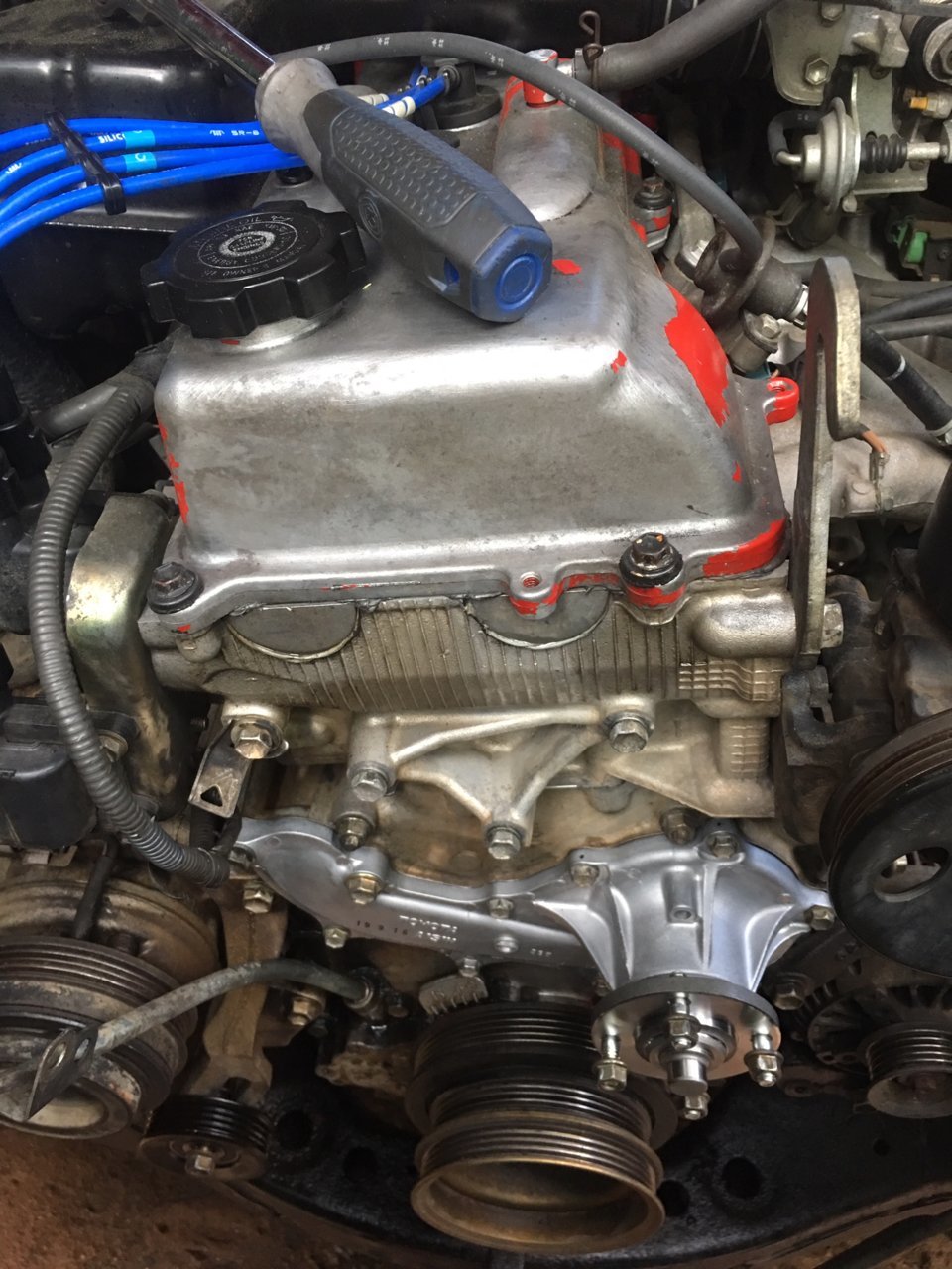

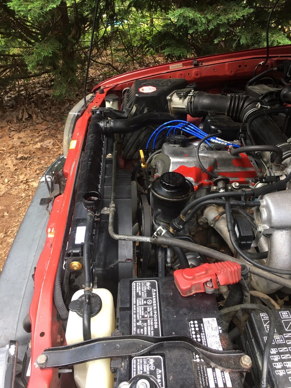

    At 222,000 Miles changed the following items, aside from belts these were all original parts.
    - Radiator (OEM Toyota 16410-0C032 , manual trans specific) - found crack in original
    - Thermostat (OEM Toyota 90916-03120)
    - Thermostat Gasket (OEM Toyota 16325-76010)
    - water inlet at thermostat (broke the original by over tightening the nuts) (OEM Toyota 16321-0W010)
    - Lower Radiator Hose (OEM Toyota 165720C021)
    - water pump (OEM Toyota 161007-944583)
    - water pump gasket (OEM Toyota 1612475030) **note: water pump above comes with water pump gasket**
    - PS adjust pulley - Dorman on Amazon (419-627)
    - AC adjust pulley - Gates on Amazon (38031)
    - Accessory Drive Belt - OEM Toyota 900809112583 Pwr Steering Belt
    - Accessory Drive Belt - OEM Toyota 9091602336 Alt Belt
    - Accessory Drive Belt - OEM Toyota 993642087078 AC Belt
    - dipstick tube O-ring gasket (OEM Toyota 96721-19010)
    - Cleaned temp sensor at water outlet
    - cleaned oil leak around oil dipstick guide tube
    - cleaned general area including fan and fan shroud
    Relatively easy job. Just took my time as its not my daily driver. Used Toyota Tacoma service manual book.
