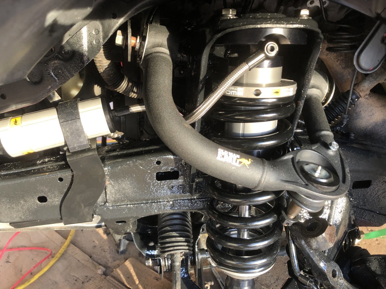

    I just recently installed these and got a fresh set of duratrac 285/75/r16 mounted up. Wondering if my alignment numbers need to be tweaked or not. So far drives great but worry that rubbing may occur. No CMC and didn't have rub issues with same setup but with stock UCA (though camber was out and caused some outside tire wear). Lift is OME 885 with trim and top plate spacers. Dakar leafs

    It's ok for stock arms.
    The tech didnt understand that ideally 3.5 caster for big tires is good.
    Also the camber should be positive. Some techs shoot for 0 camber some reason. You can see the spec is 0.6 and they dropped it down.
    It's balanced and green, no tire wear concerns. But not ideal for driving in my opinion.

    Was having some issues rubbing so had the shop do another alignment. So far so good, Final numbers 3.0 for caster, +.1 camber, .07 toe
