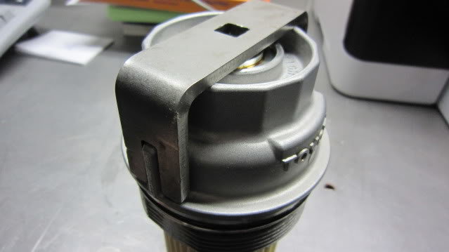

    Just to be detailed here, when removing the oil filter I start off using that tool (as shown) in my original post, to first "untighten" the oil filter, once loose then use my hand(s) (using rubber gloves) for complete removal.
    When installing the new oil filter I use my hand first, once snug, hand tighted then use that tool and turn the oil filter just a quarter of a turn with it so that it will stay snug.
    Again, thats the way I've always done it ever since I started changing the oil myself back since the 70's.
    As for the special tool used for removing the oil filter on my wifes 2016 4Runner, well just do a search on Ebay on oil filter for either Toyota 2016 4Runner's or 2016 Tacoma's. The aluminum housing will pop up and some come with that extra removal tool as well. The tool itself can also be found as well.
    You could also probably search on Amazon and find it as well?

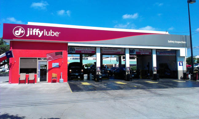

    Yeah, i use my hand when I've done it myself, time before last I has the quick lube place do it, had to use a ratchet strap to get it off. But the ratchet strap worked great for a ghetto fix.

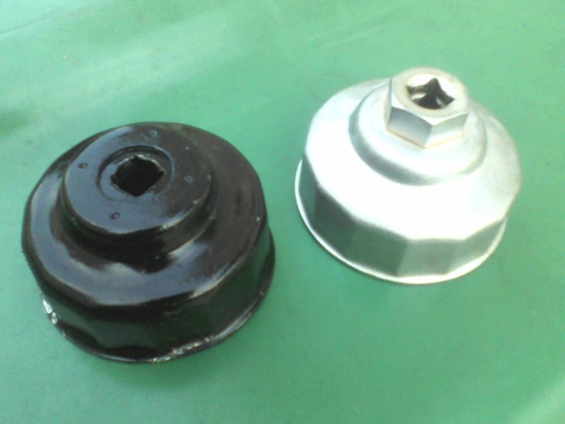

    I tighten down by hand only, but always find myself needing a little assistance for removal. Over the years I've collected a slew of oil filter wrenches. The one I use on my 4.0L 2nd Gen says 75MM on it. I have no idea what the actual measurement should be. I just know this one fits on the filter w/o slipping or getting hung up on it.

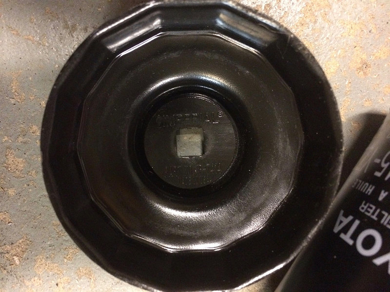

    The one that works best with my OEM filters (I use 90915-YZZD3) is made by Imperial, model is IF-7414. I got it from my dealer parts guy, it's the one they used in the shop. That would have been around year 2000 when I got it, it fit the 90915-20004 I was able to get for a while and the 08922-02011 before that.
    According to the Australian Imperial Tools website the IF-7414 is 74mm, 14 flutes. Pretty obvious how they name them.
    http://www.imperial-tools.com.au/metal-oil-filter-cup-wrench

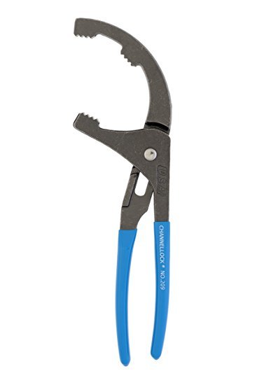

    This one is perfecto
    https://www.amazon.com/gp/aw/d/B00239WHLG/ref=yo_ii_img?ie=UTF8&psc=1
