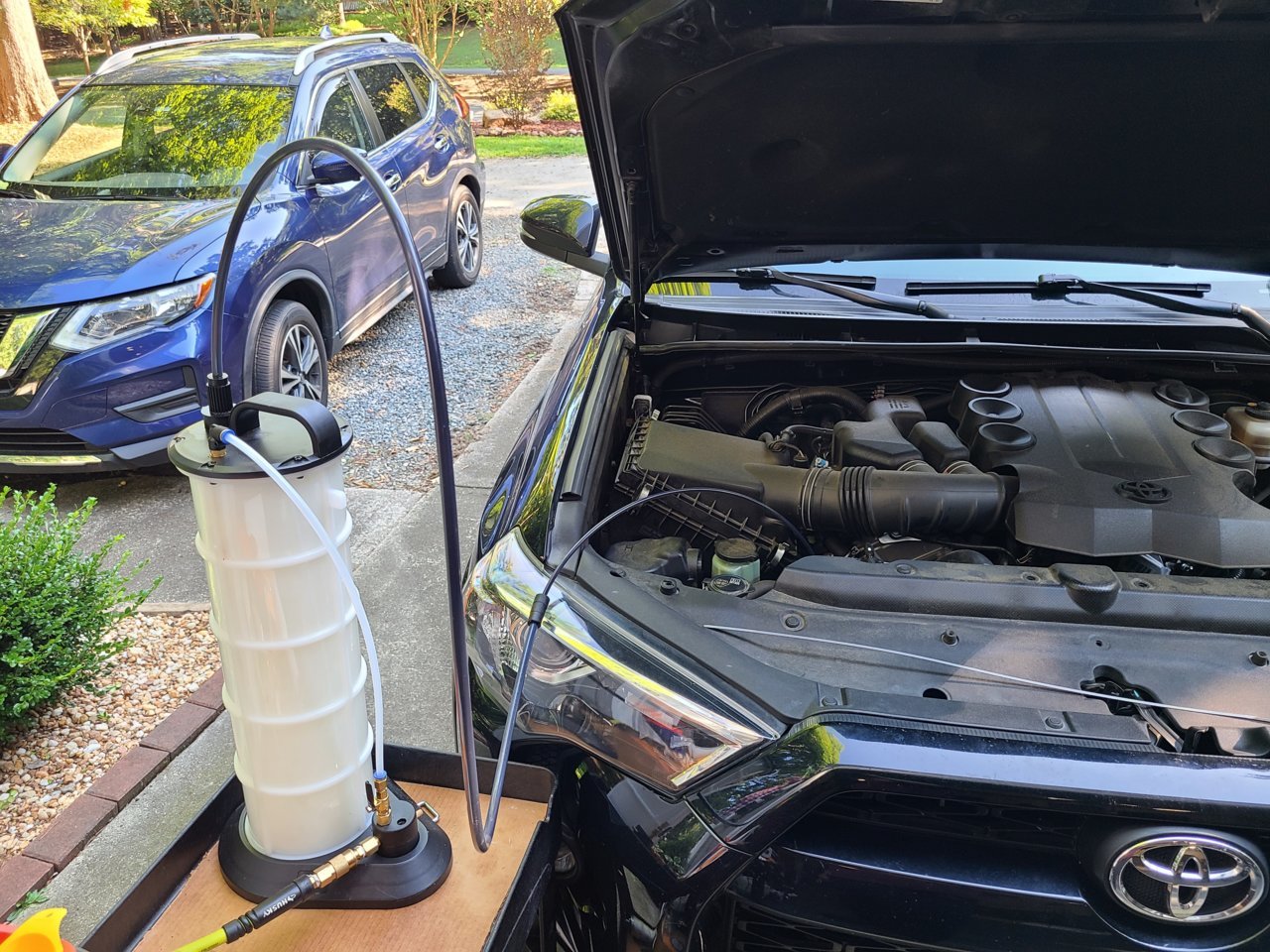

    Some will hate, but I vacuum the oil in all my cars, and then change the filters. Work’s incredibly well.
