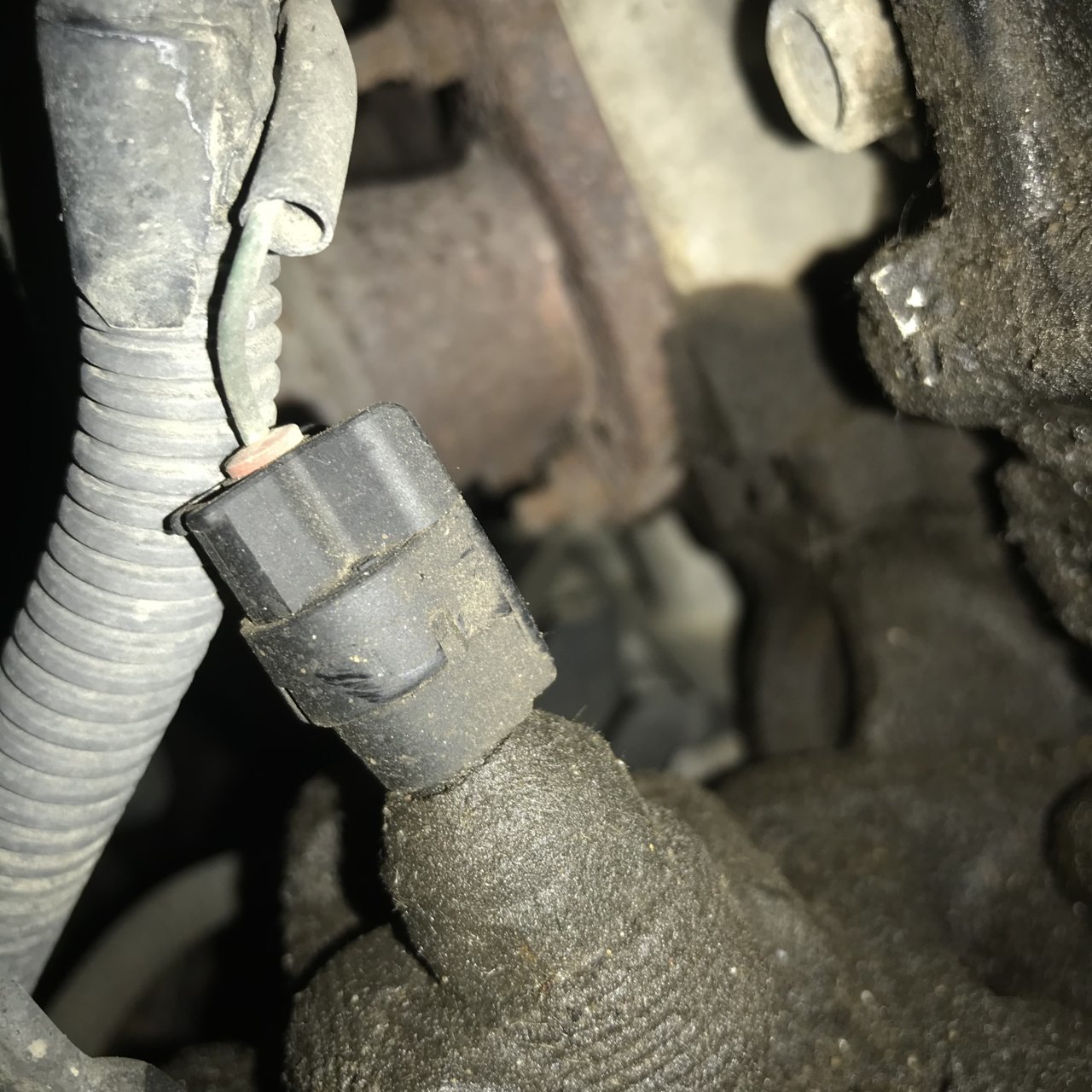

    2006 Tacoma with a V6 has oil buildup on side of engine near dipstick. It’s below the exhaust manifold near what looks like a sensor. 1474B038-2E68-4671-8DC8-CE804EEDDDD7.jpg A1360A6C-2AF3-437D-87ED-12BA28CCDCE9.jpg DBCCF2DF-E870-415E-A9E8-CA0A4343F1A1.jpg DE28F717-E613-4ADE-A442-7BC0D957A8BE.jpg Is this a common issue or what could possibly be causing this?

    Clean it all up nice a pretty. Then drive it for a bit and then you will be able to see where it is leaking from.
    There is a known issue with the timing cover leaking on the passenger side.

    Thanks. I just watched a video that someone took of their timing chain cover leak. It looks like the exact same thing. Yikes!

    I'd also look at the VVT screen bolt. It's right there in your pic and it could be leaking too.

    Third pic. Your pics are so close up it's hard to get perspective on where that bold head is located, but it looks an awful lot like the VVT bolt you remove to get to the screens.

    Here are the locations for the VVTI Filter Screens: One in each side.

    No the filler neck is on the other side. I have the same issue. But never any drops on the ground so I'm leaving it alone.
    It's the infamous timing cover leak especially since it's a 06
