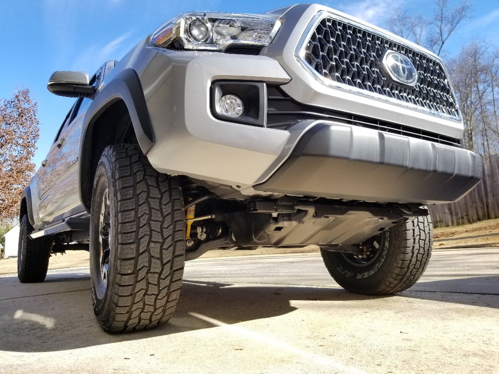

    Just wondering how different the offsets are ?
    I have plenty of cab mount clearance, but very light rubbing on the UCA's at full lock.
    Just wondered if the Pro wheels stick out further than the OR wheels and might give me the little bit I need to stay off the UCA's.
    Just looking for an excuse to upgrade wheels. :)
    Thanks in advance !

    Pro wheels are +13mm offset
    Off Road wheels are +25mm offset
    All things being equal Pro wheels will stick out about a half inch more.

    First post nails it ! :thumbsup:
    EXACTLY what I was looking for.
    Now to convince the wife that we need another set of rims. :rofl:
    I found this in a search but did not see the Pro wheels shown.

    I had the same problem. I put a set of BFG KO2 285/75/r16 tires on the stock wheels and got slight rubbing on the UCAs. The Pro wheels solved it perfectly. And look so much better than those snowflake rims. Good luck with the wife.

    Same thing with the 4Runner PRO wheels as far as being 1/2” farther out. Sits plush with the fenders, or perhaps a 1/4” inside. :thumbsup:
