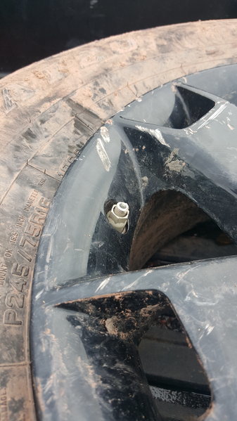

    I know this thread has been dead 6 years, but on my Google searches for how to replace a valve stem, I'don't just like to share with you my carnage picture. I was in a v-shaped ravine a day clipped a rock jutting from the side. Next thing I knew I was flat. So let it not be said that it can't happen. Lol

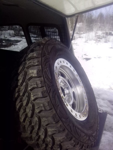

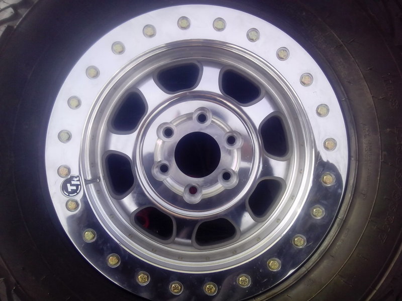

    I carry 3 spare steel valve stems beadlocks make it possible for me to change alone. I would first throw the spare onIMG_20160313_165842.jpg IMG_20160313_165516.jpg
    So I would only need a few comon tools and an torque wrench for the ring and time lol takes 4 passes with the torque wrench at different torque s
