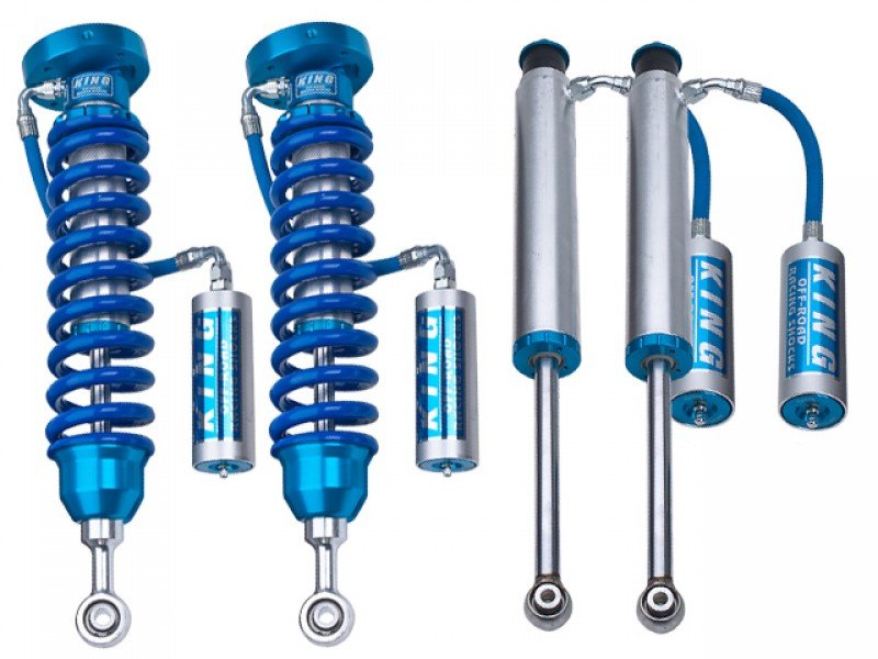

    That is a drop bracket lift, requires cutting the frame to drop the front diff. Very difficult to reverse if needed and no extra clearance or performance from it. Stick with 3 inches below.
    Each kit has different components to it is all. Minimum is
    Front shock/coil over rear shocks, new leaf pack, new upper control arms, new u bolts, dims, carrier bearing spacer
    Reservoir, bypasses, and the like are not really needed. You may need extended brake lines.

    2400 for the kings
    800 for the leaf pack
    600 to 800 for uca
    Ubolts and brake lines around 250
