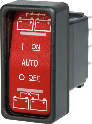

    Does anyone have any install instructions for the wiring of the Blue Sea Switch?
    My kit gets here today and I'm doing the install tomorrow. :bananadance:

    PS. You do not need the isolation wires for most applications. Cut them and cap them.

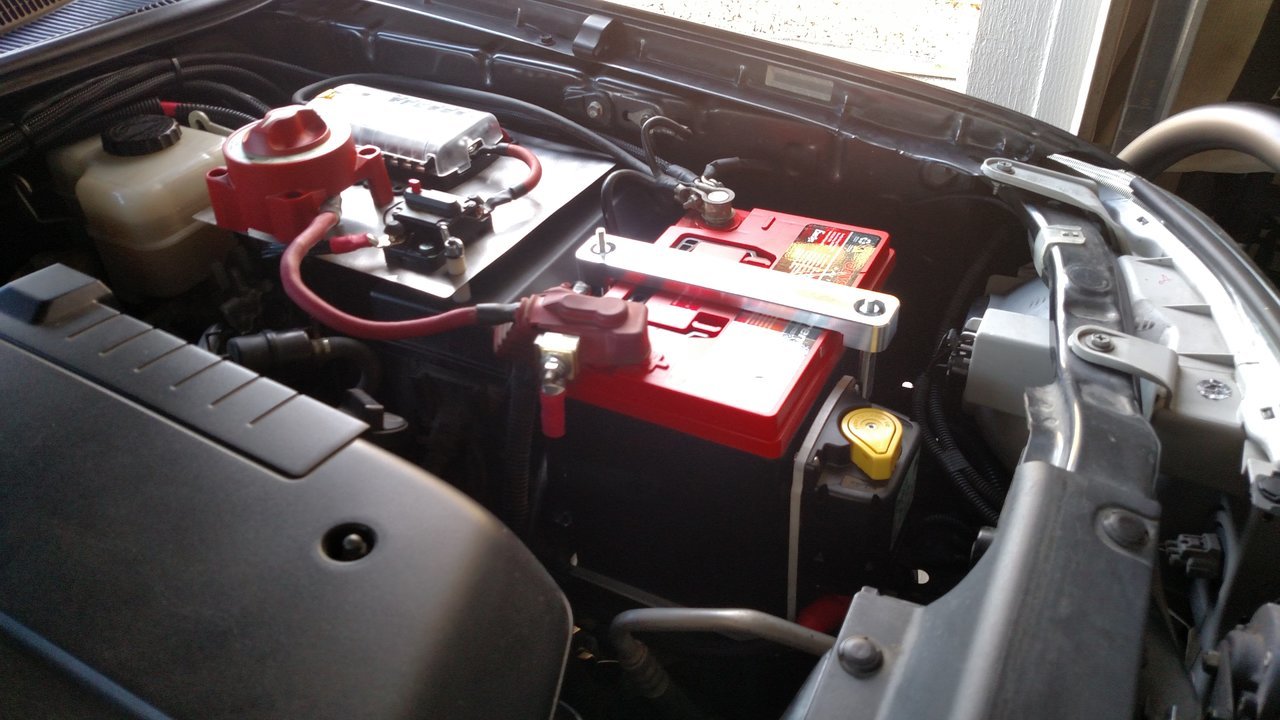

    @HeliMedic Do you make/sell a wiring harness for the Blue Sea Switch that goes in the cab? Also, I am also interested in the blue sea bed outlet. Do you sell these with the wiring harness as well?

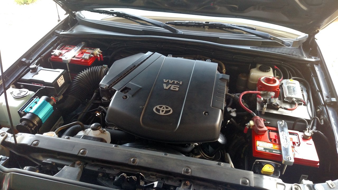

    Has anyone considered/tried to move the factory fuse box back towards the firewall at all? I only need about 2 inches to put both of my batteries side by side. From what I can tell I have plenty of slack in the factory harness and it mounts in two places, one on the inner fender well and one on the batter holder. I can fab something up to support the fuse box in its new location. Please pass on your thoughts on this, thanks.

    WOW! Very nice install! You've got a lot of stuff going on under there. Kudos for keeping it clean.
    There is very little for lead time on the outlet systems. A couple days max.

    The harness that I make for the in-cab switch is wired directly to the ACR. So, I do not make one that I can send out. BUT, I can wire your ACR for a switch if you send it to me. I do it all the time for folks. The cost is $80 right now and that covers materials and labor.
