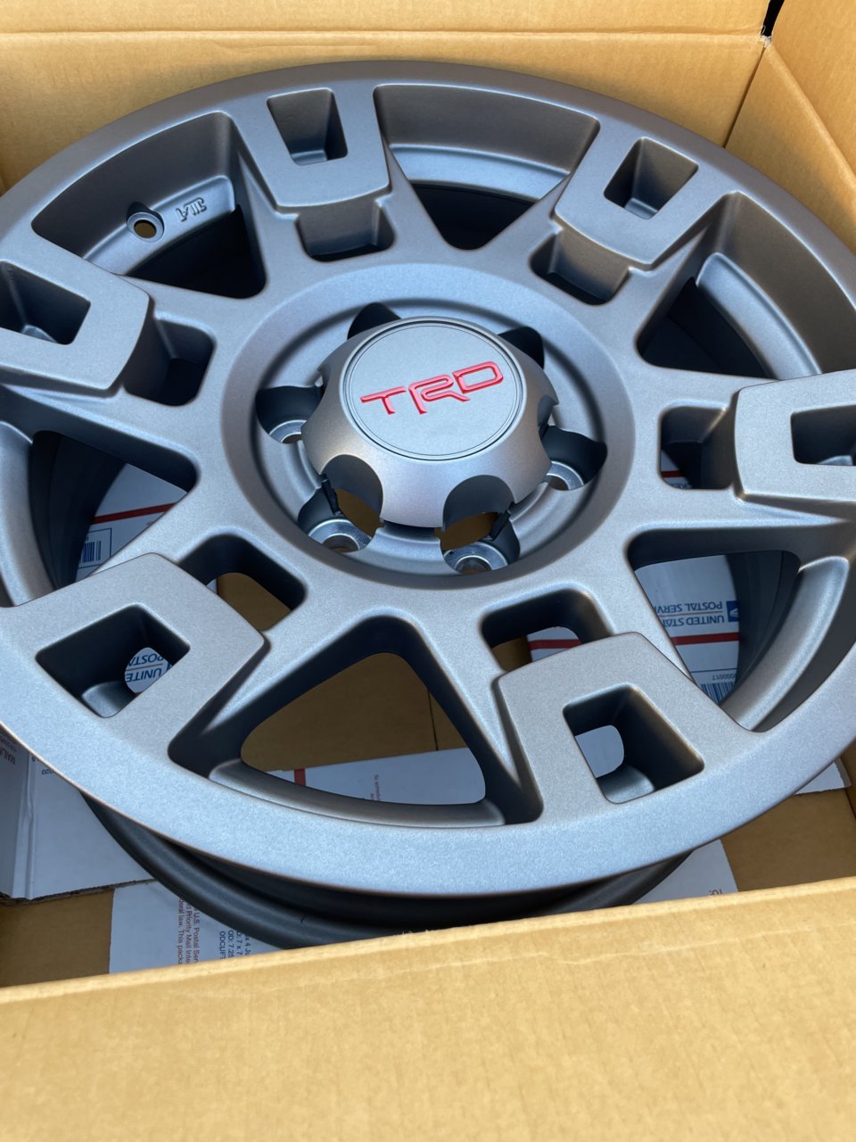

    Go with OEM. I had aftermarket pro comp rims and they didn’t hold up. The trd rims fit so nice and be hub centric the fit perfect 748E5F89-2946-4E88-A821-DB6ED73C6330.jpgF59D7F55-AC19-48DB-8637-3759FEE1CBF3.jpg

    You can't beat OEM for quality.
