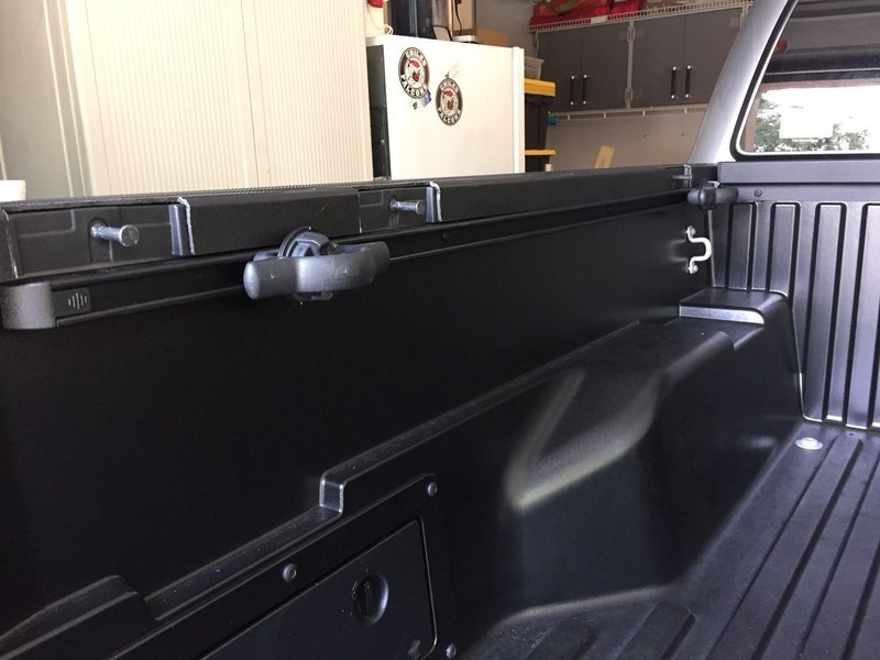

    Tools needed Torq bit T-27 and 12mm socket for the bolt.
    1) Remove bed rail to access Threaded mount holes. Bed rails pull off, I started on rail closest to cab and pull straight up and work your way down to tailgate.
    2) Mounts installed.

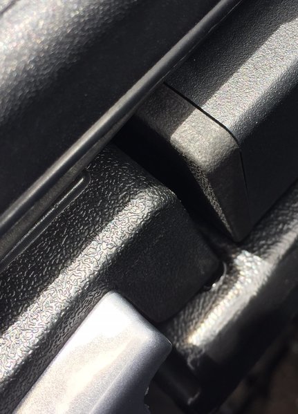

    3) Cut bed rails. (I used a Roto-zip tool)
    4) Re-install bed rails.

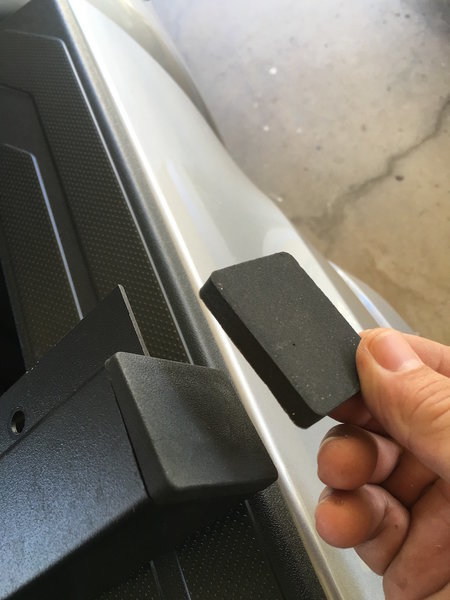

    5) The only issue is that trucks purchased with the OEM cover have a per-installed bed seal along the bed closes to the cab. It may be possible to purchase from dealer (I couldn’t find part #). Another option to seal gap is to use a window putty or water proof seal.

    I have an extra set of the foam seals for the front rail if anyone needs them. Pictured above in installation instructions. I'll mail to the first person that needs them.
