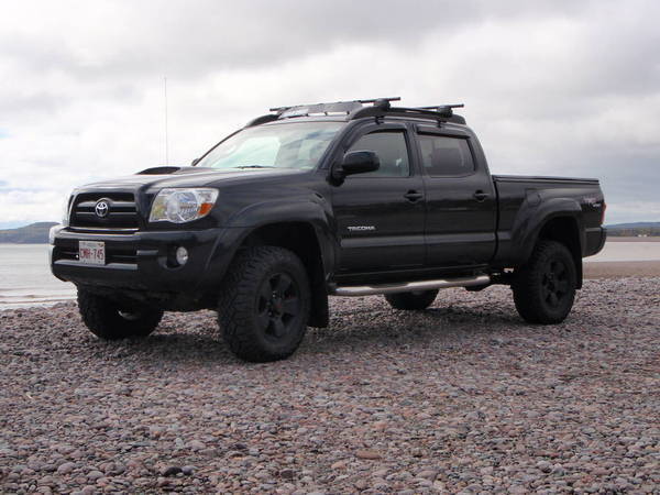

    Member Squad314 has those towers on his oem rack. You could look up his build or gallary. He has used them on two tacomas.
    This is a pic from his gallary

    very nice...thanks!!
