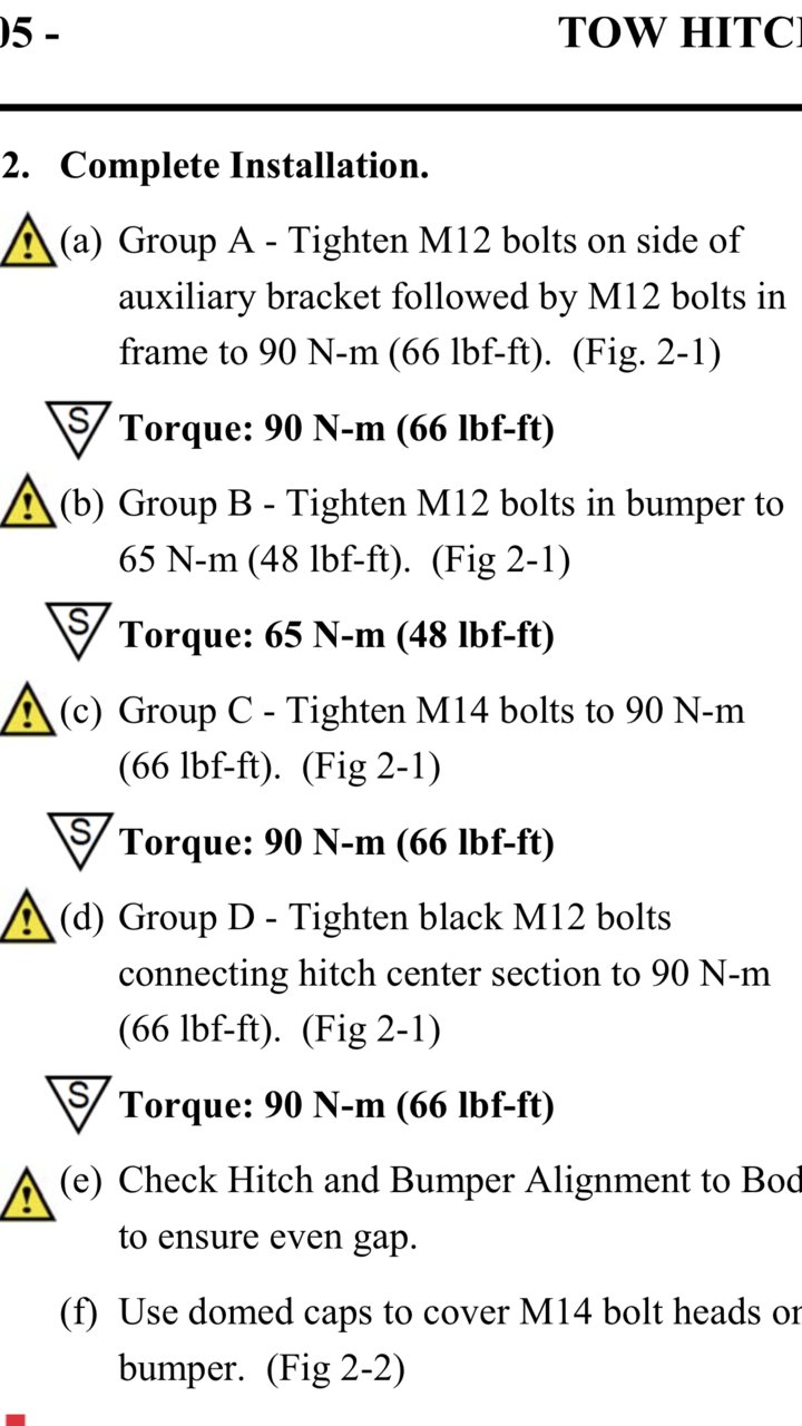

    Hey all! I did a pretty extensive search and downloaded the partial FSM here. I cannot find the torque spec for the factory tow hitch. Specifically I need the spec for the 2 bolts that fasten the hitch receiver to the bumper bar. The 2 with the raised plastic cover.

    Group c 90 nm

    WhiteDog,
    90 nm
    BIG THANKS!
    303tacoma,
    That's the same partial FSM I downloaded. I couldn't find it in there...o_O
