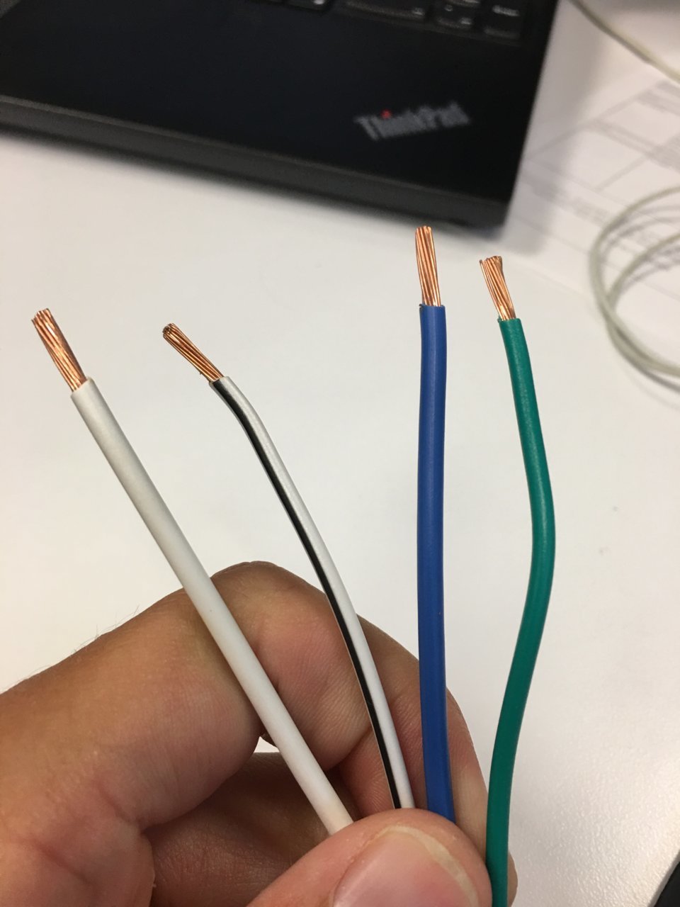

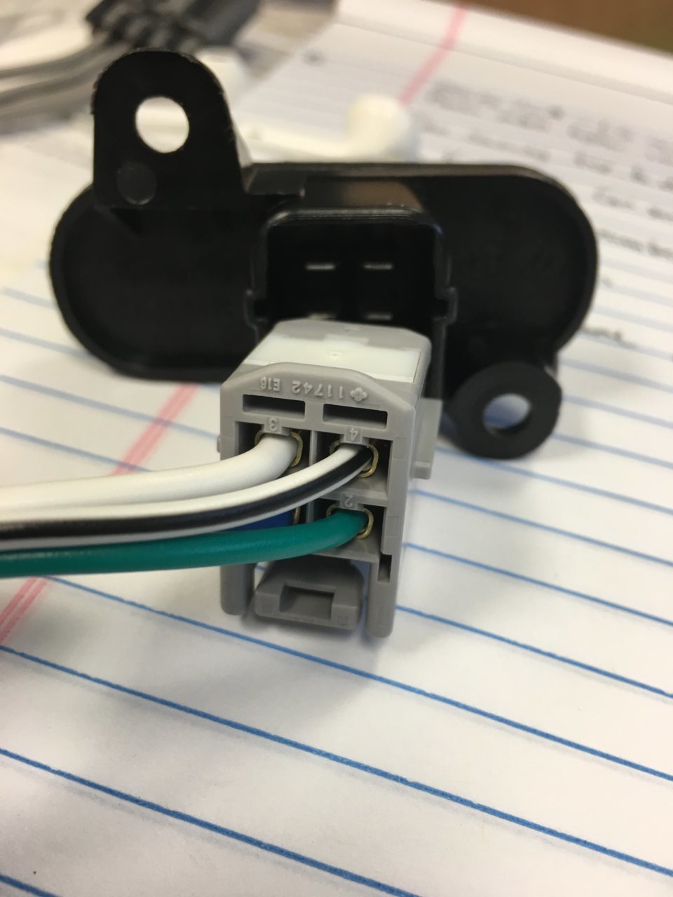

    So now I decided to go back to all OEM because idk what else to try. The kit that Toyota recommends is 87138-04070 (resistor) and wiring adapter (82141-04Q80). This resistor has the terminals in a square pattern rather than a line. I'm assuming this is from a 3rd gen and hopefully changes were made to fix the well known issue.
    Anyway, went to install the new adapter and the wires are different. The wires on the Dorman resistor are labeled ABCD, and the new resistor has ABCD labeled right next to the terminals. I thought they should be matched up, but two wires are 16ga and two are 14 ga. Wires A and C on the new adapter are 14ga, whereas on my truck wires C and D are 14ga. Does anyone know how these wires should be reconnected with this kit?
    Wires on truck:
    A - Green, yellow stripe (16ga)
    B - Blue, black stripe (16ga)
    C - White, blue stripe (14ga)
    D - White, black stripe (14ga)
    Wires on OEM adapter:
    A - Solid white (14ga)
    B - White, black stripe (16ga)
    C - Solid Blue (14ga)
    D - Solid green (16ga)

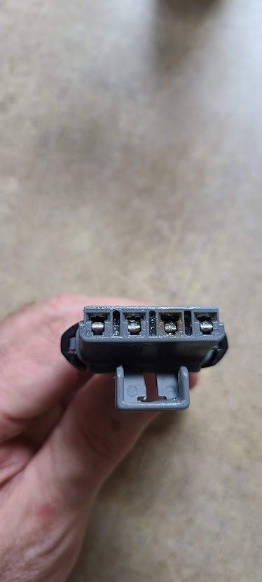

    I dunno. LOL. It just seems weird that they would put numbers on the schematic if they didn't correspond with numbers on the connector housing.
    On the 2nd gen connector, at least the connector letters sort of correspond with the order of things.
    Connector=schematic
    A=4
    B=3
    C=2
    D=1
    And to confuse things even more, the 2 large wires on the 2nd gen connector are white/black and white/blue. On the 3rd gen connector, the large wires are solid white and solid blue.

    So none of this made any sense with all the numbers and colors and letters. I went to Toyota today and worked it out with them. Caribe's post in #2 is accurate. This is the proper way to hook it up. I agree that it does not make sense that you would have a larger gauge wire hooked to a smaller gauge wire. However, Toyota made it this way. Hooked mine up this way and it works like a champ. Hope this helps if anyone is still trying to figure it out.
    Old Harness -> -> New Harness
    White/Blue Stripe -> (Hi) -> Solid White
    White/Black Stripe -> (Lo) -> White/ Black Stripe
    Green/Yellow Stripe -> (M1) -> Solid Green
    Blue/Black Stripe -> (M2) -> Solid Blue

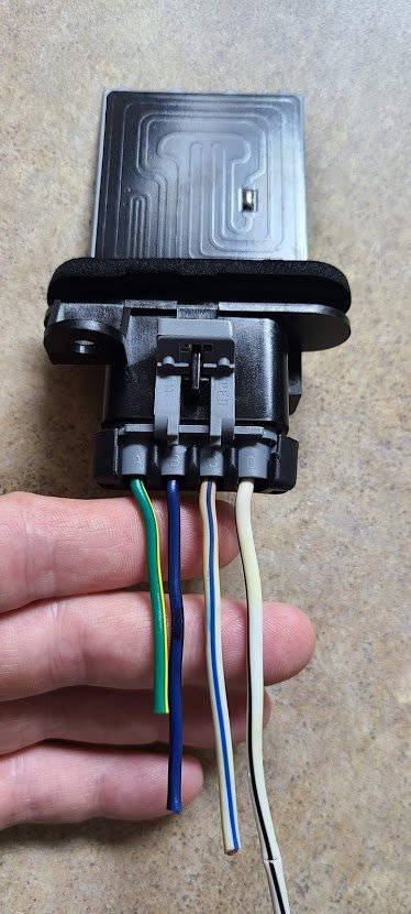

    Straight from Toyota...vmacocsoak_2315982145933-1-received_570953809975021.jpg
