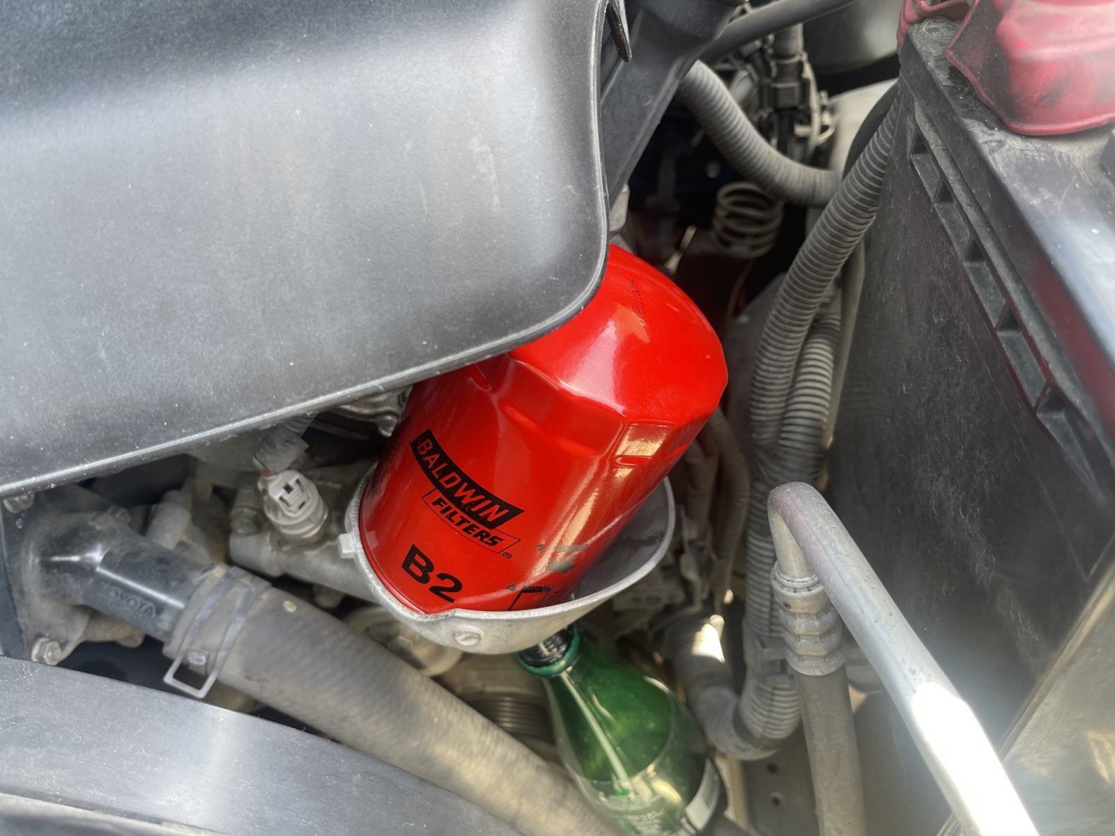

    Baldwin B2. But of the 3 I bought, 1 was a tad bit bigger and wouldn’t fit.

    was researching and saw a bunch of pics of folks using other larger filters similar to that but different color
    appeared to be the same concern, clearance to the engine cover
    IMO probably wouldn’t be a big deal to cut it, and worth it
