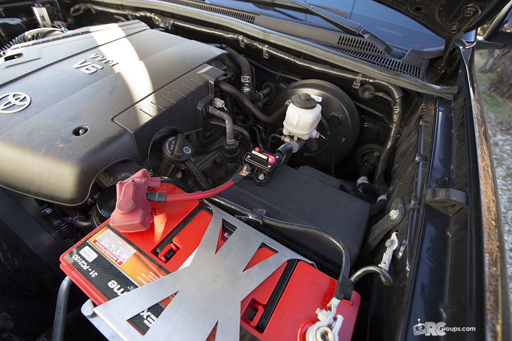

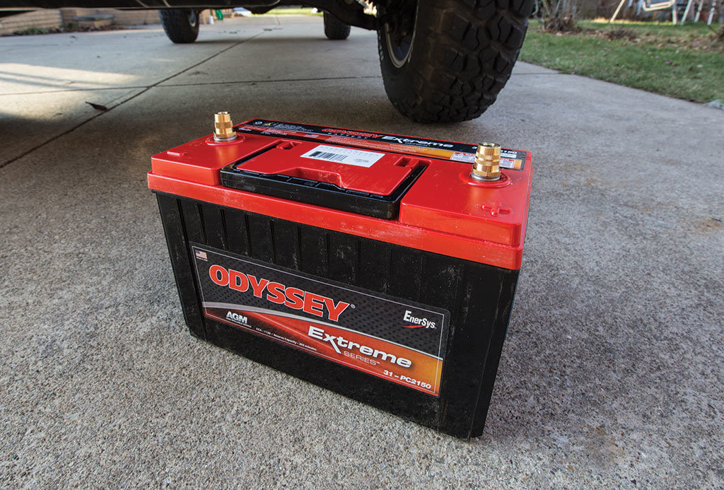

    My Odyssey PC2150 group 31 battery lasted just shy of the 5 year mark (photos below taken in March 2016 during installation). At roughly $430 it's a tough pill to swallow again; Im looking for a cheaper option, maybe even a slightly smaller capacity battery as I'm not off-grid truck camping as much but would still like some reserve capacity on hand for the occasional overnight. Any advice? Thanks in advance!

    I totally get what you're saying. The unique thing about the group 31 is that it has more reserve capacity than some dual battery setups. I can run my fan all night in the tent, listen to music, power lights... or whatever Im doing on battery alone, then wake up and brew coffee and still have plenty of reserve. It's a 70lb battery with amazing capacity. That's why it's 400+. I really dont want a standard $100 battery because I do off-grid every once in a while still and the extra capacity is key IMO.
