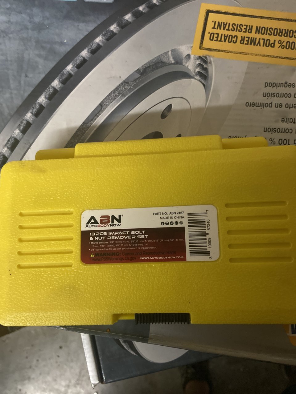

    I ordered this from Amazon and it got me there. I used a 90 degree bit holder on my impact to get it wedged on and then a ratchet to break it open.

    Thank you. I’ll check it out. Appreciate the reply.
