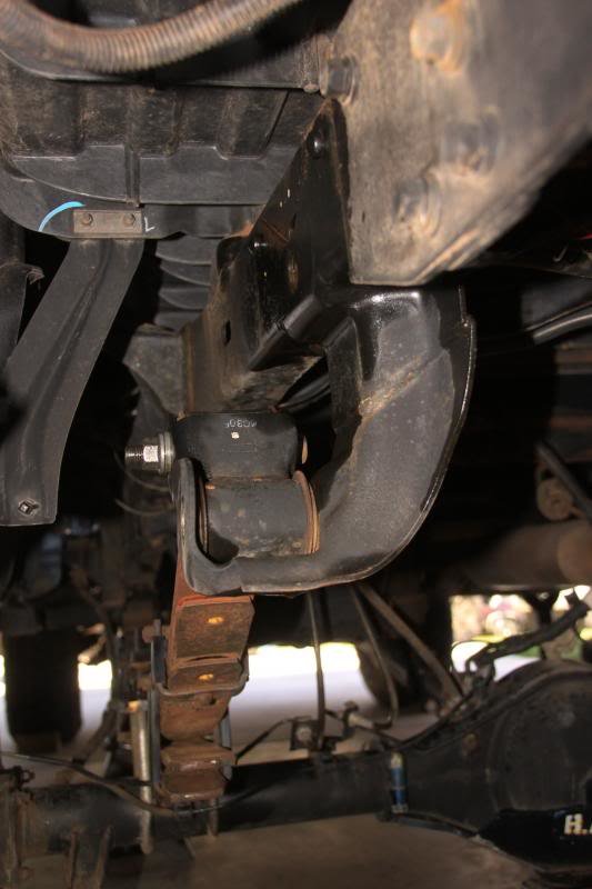

    Flex shackle pic:

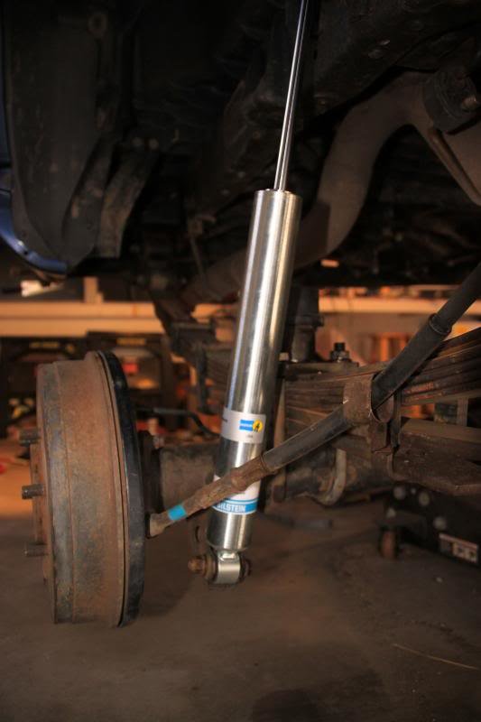

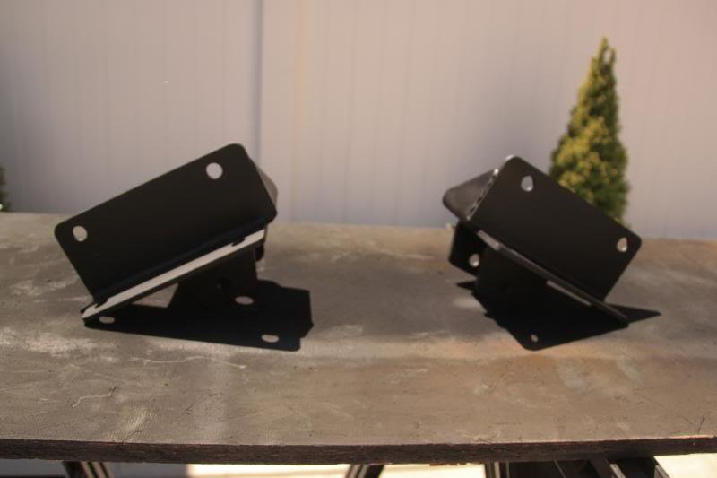

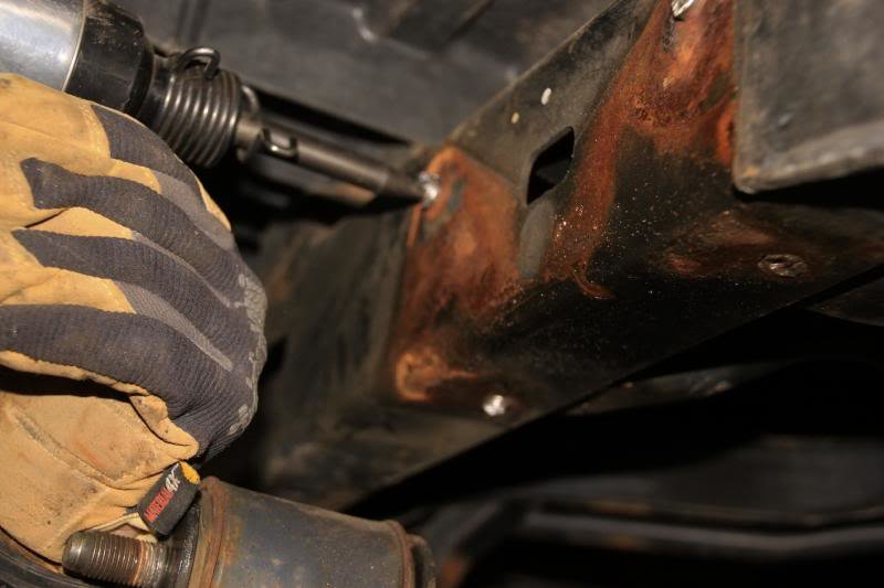

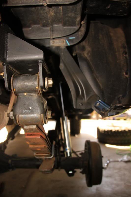

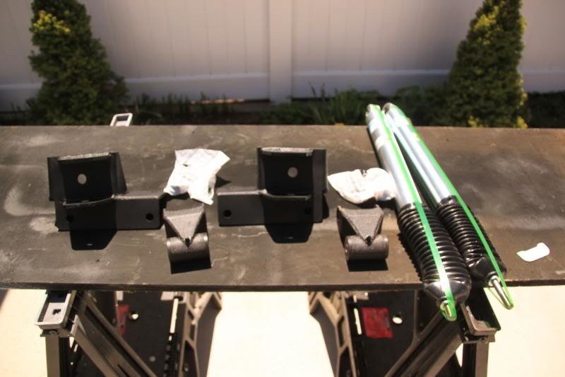

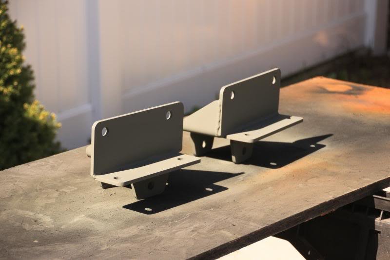

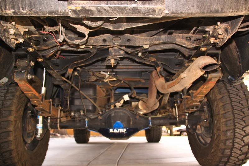

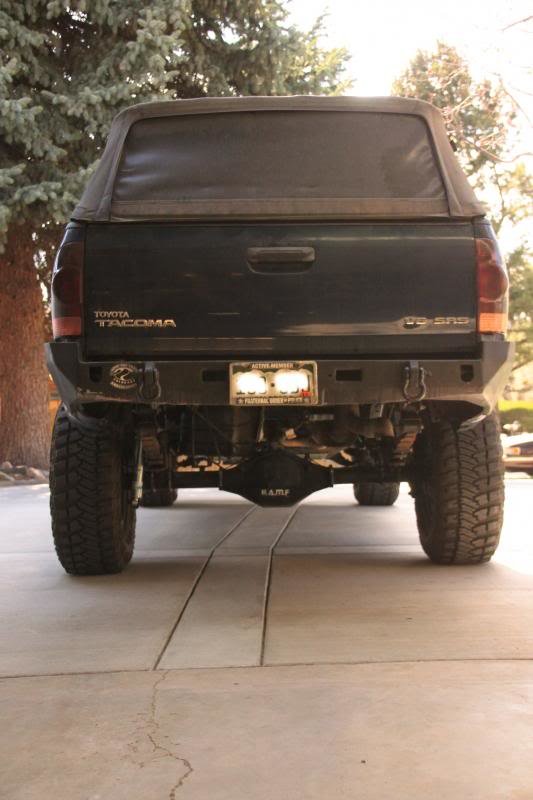

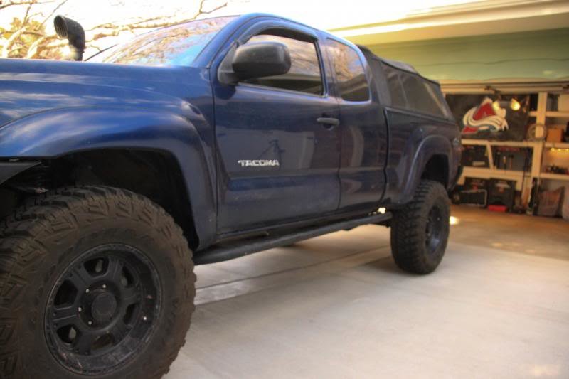

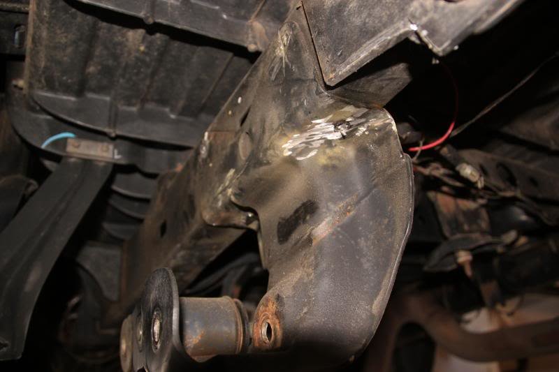

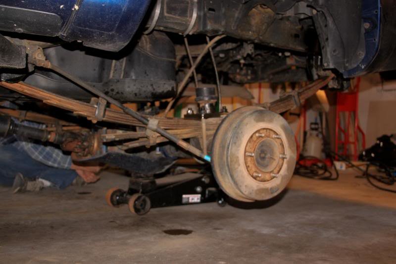

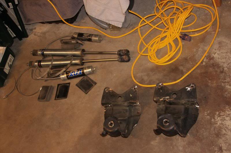

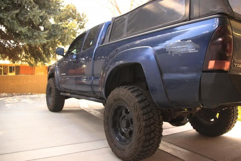

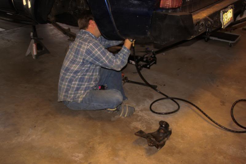

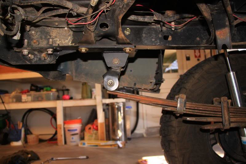

    so here's some pics from today...you might have already seen the pics on live, but here's some better pics.
    tearing the old setup down
    priming the mounts
    what needs to be taken off
    rivet heads off
    painted
    one hanger down
    time to get the rest of the rivets out!
    out with the old
    in with the new
    longer shocks
    bam!
    droop angle
    ride angle
    no more hangers :D
    betty's got some rake again
    sits a bit higher
    next up...flexing!
    sometime :(

    and unfortunately the defined shackles did not fit over the spring bushings....so those did not make it on :(
    gotta get in touch with them and see what the issue is..
    might look into other shackle options..
