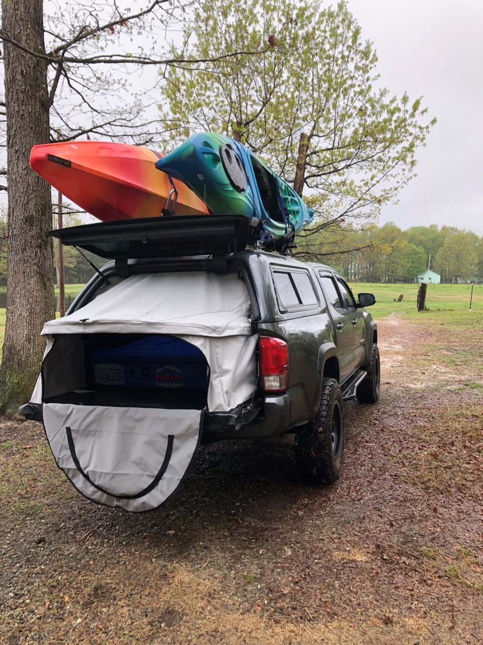

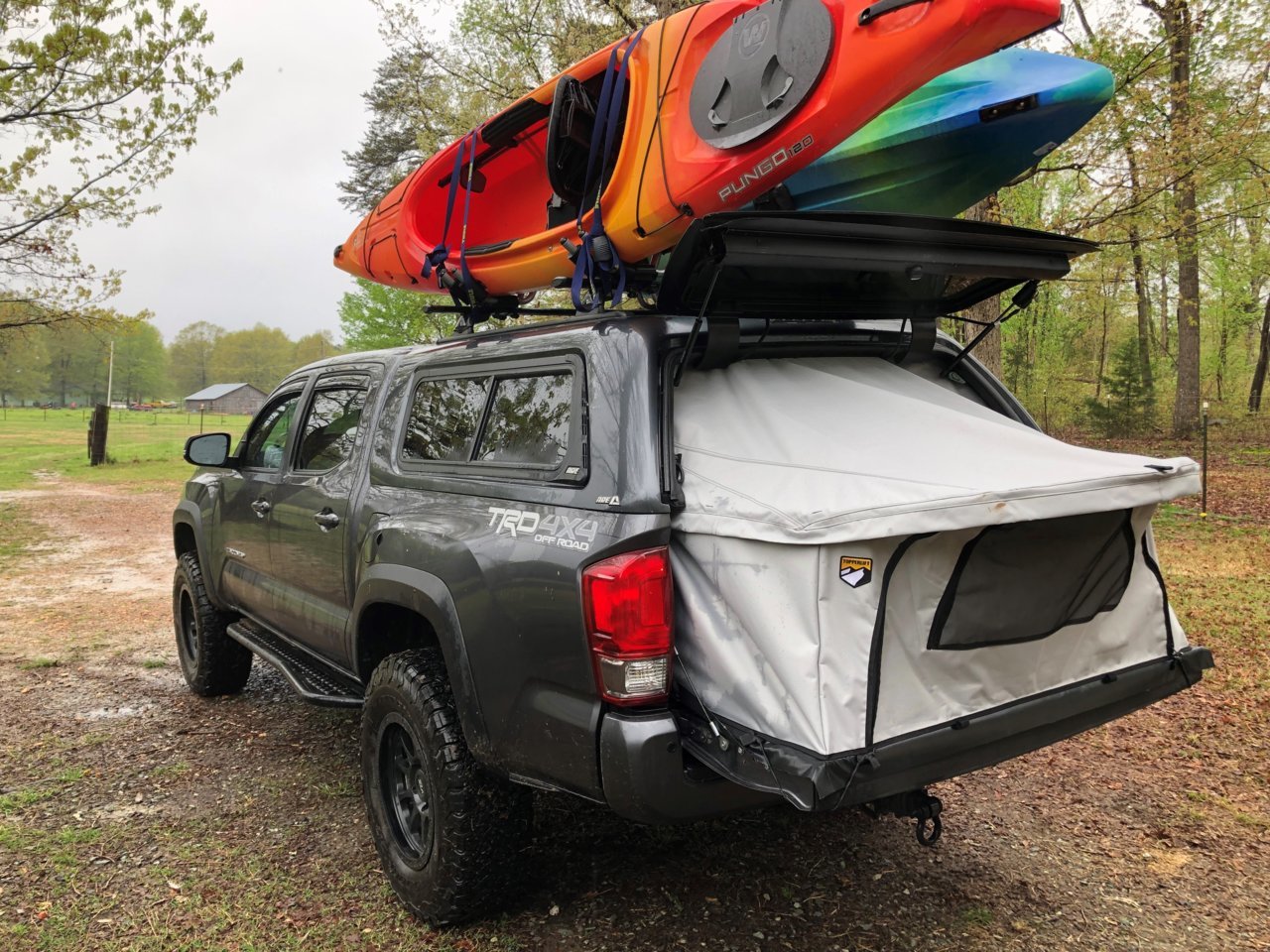

    We have camped several times using the Nomad and the last two times it rained. The nomad leaked along the seams/ stitching. Has anyone else come across this and if so how did you stop it? We use a truck bed air mattress and sheets inside...once the sheets get wet moral drops quick!

    All tents leak on the seams, unless they are sealed and most aren't. Get some good seam sealer, turn the tent inside out and seal all sewn seams.

    Quick update, I did end up seam sealing it as a precaution, and I've hard zero leaking issues before or after. I've been in dumping rain and full on blizzards.
