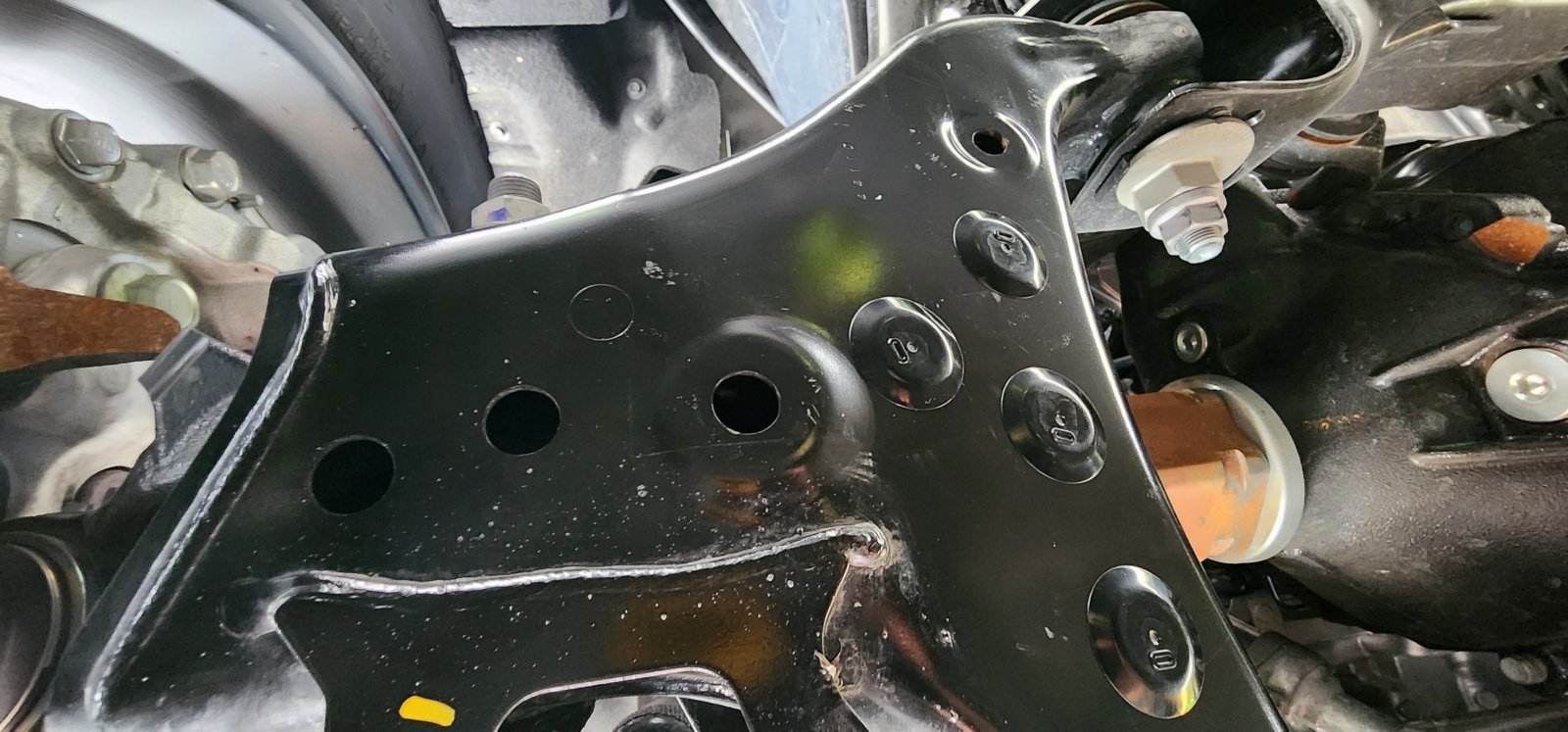

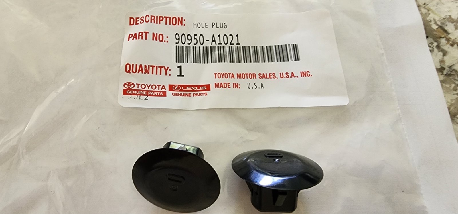

    Picked up the plugs today. They are not rubber as I thought but rather a hard plastic. They just clip in.
    Those are the 4 holes they go into.
  12. Jul 3, 2024 at 10:10 AM
    #52
    CrispyTacoLover
    CrispyTacoLover Well-Known Member
    Jun 27, 2019
    #297647
    4,537
    2024 Tacoma and 4Runner Offroad Premium
    Solved the whistling?

    Yes, no more whistling!

  19. Jul 3, 2024 at 1:12 PM
    #59
    Visa_Declined
    Visa_Declined Well-Known Member
    Feb 1, 2024
    #442975
    419
    24 TRD Off Road Solar Octane
    Those are the same plugs that run down the sides of the frame. I removed 10 of them that size, and 4 oval ones when I installed my rock sliders. They're extremely easy to break if you ever have to remove them.
