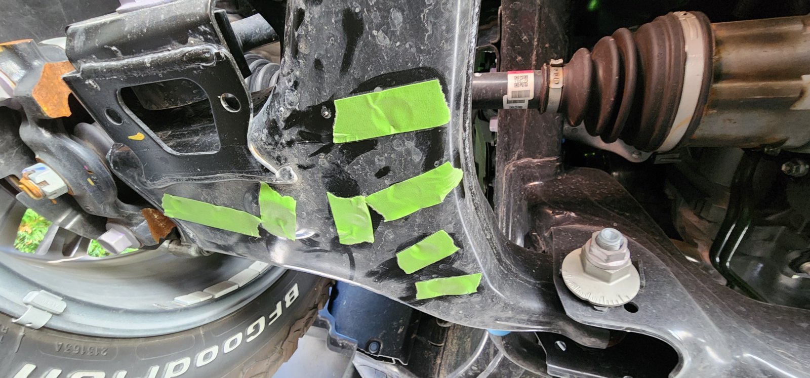

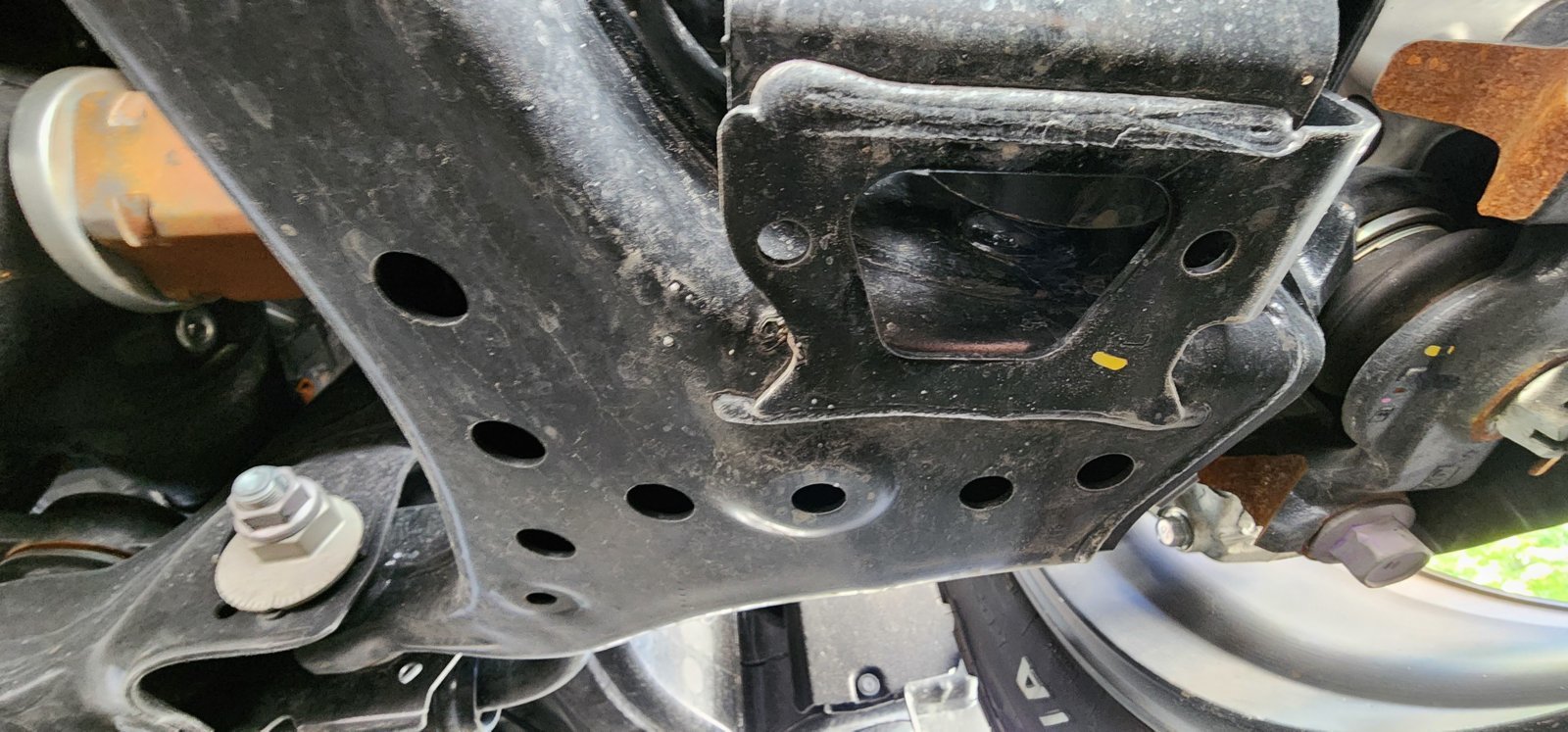

    I did some testing and I think I found where the wind noise is coming from. After using painter's tape to cover these holes on both sides, the wind noise is gone!!! Not sure if all the holes create the noise as I didn't try them one at a time but it's definitely gone now. I will stop by the dealership tomorrow (it's Canada day here today) and share this with them. Hopefully there will be a more durable solution than tape available soon! Not sure if the rubber grommets previously discussed (3rd gen) would fit and the question is, since some holes are necessary for drainage, which holes should be covered?
    So any type of skid plate wouldn't get rid of that noise in this case.

  11. Jul 1, 2024 at 8:08 PM
    #31
    Jakedawgy
    Jakedawgy Well-Known Member
    Jan 25, 2020
    #317178
    184
    Nation's Capital, Canada
    2024 Underground TRD Sport Premium
    If someone with a TRD OR could post some pics of the underside of the suspension arms we'd have a better idea if there is a difference with the Sport's.
    I replaced the painters tape with black duct tape and drove about 50 miles, highway and city at various speeds and I can confirm the howl is definitely gone. Somehow it feels weird to put duct tape to fix a problem on a new 60k truck though. Hopefully Toyota comes up with a fix... o_O

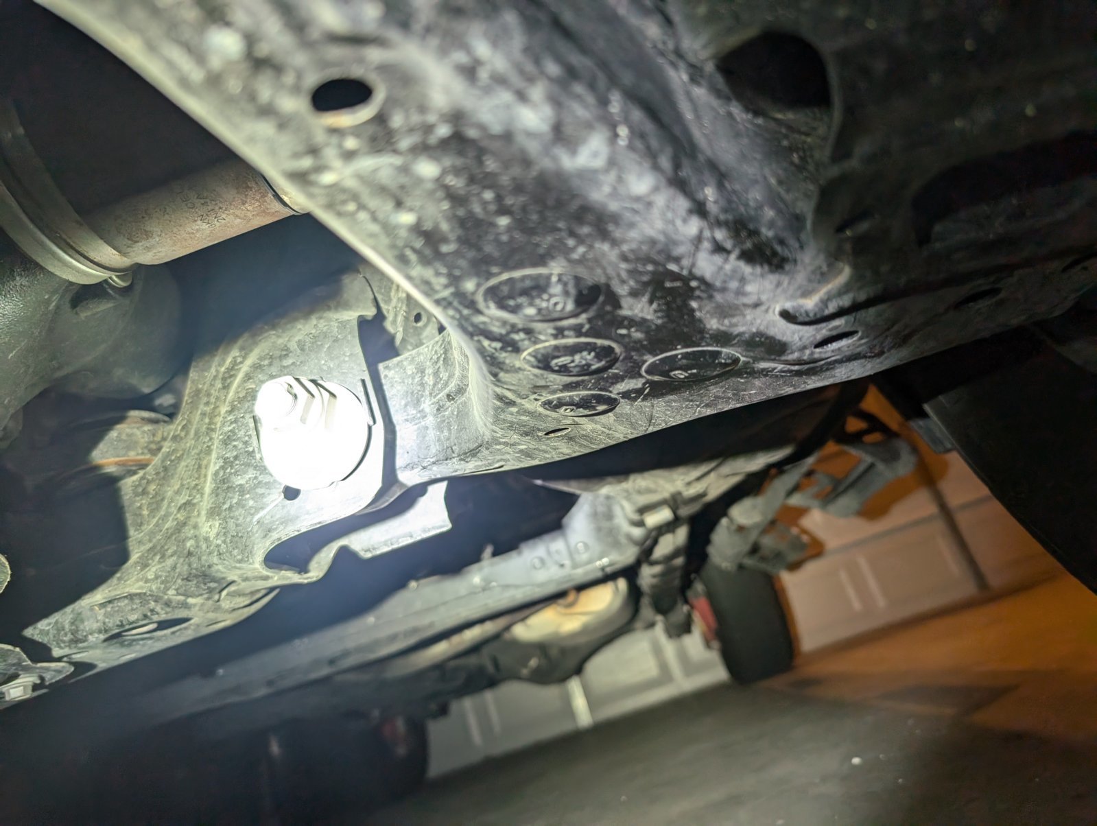

  13. Jul 2, 2024 at 10:30 AM
    #33
    Jakedawgy
    Jan 25, 2020
    #317178
    184
    I got this pic of the underside of a TRD OR control arm from another forum and they come equipped with 4 rubber plugs for the holes. I went to my dealership and indeed the pack of 8 plugs is listed in the parts list on OR and Trail hunter trims but not on the Sport. It is available for purchase for $51 CAD... I did order them but it's a shame Toyota installs them on some models and cuts corners on others...
    So far the Sport comes with no cross member to install a decent and better skid plate and no rubber plugs to prevent the truck from turning into a whistle...
