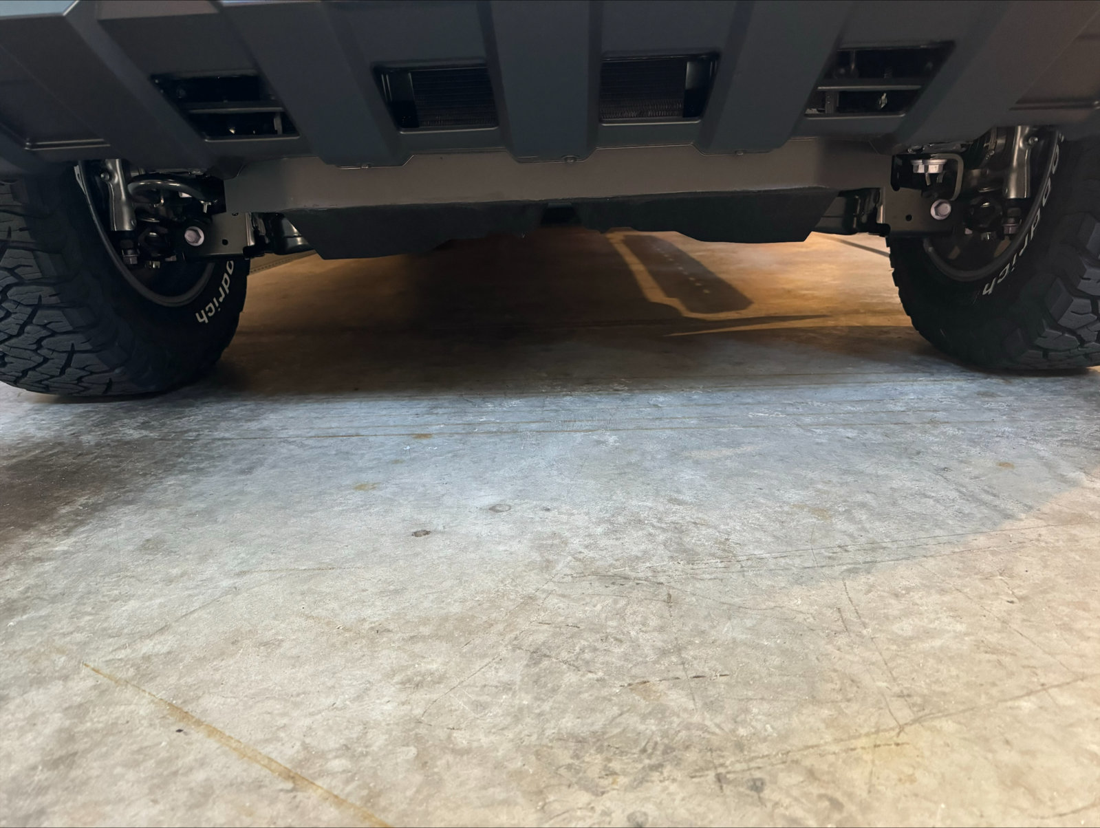

    Hello everyone. Has anyone removed the air dam from their 2024 Tacoma? I removed mine and now I have a low whistle type sound when I go from about 30 to 45 mph. Almost sounds like a tire noise but I think it is because I took off air dam and it’s the air passing under the truck that’s making that noise. Gunna put it back on to see if noise goes away.

    Cutting and trimming the factory chin spoiler to cover the slots above the sports skid plate eliminates the Nosie you are hearing.processed-39225A86-C7F9-4CE9-B755-8809474C7FDC.jpg

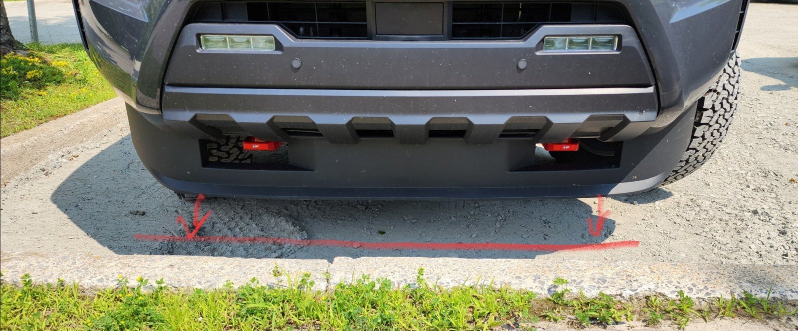

  17. Jun 18, 2024 at 12:41 PM
    #17
    Jakedawgy
    Jakedawgy Well-Known Member
    Jan 25, 2020
    #317178
    184
    Nation's Capital, Canada
    2024 Underground TRD Sport Premium
    Chin spoiler would have hooked on that tiny little curb when I parked. I bought a truck, not a Mini Cooper FGS! I'll be trimming that on the weekend and covering the whistling holes until I can find a better and affordable skid plate...
