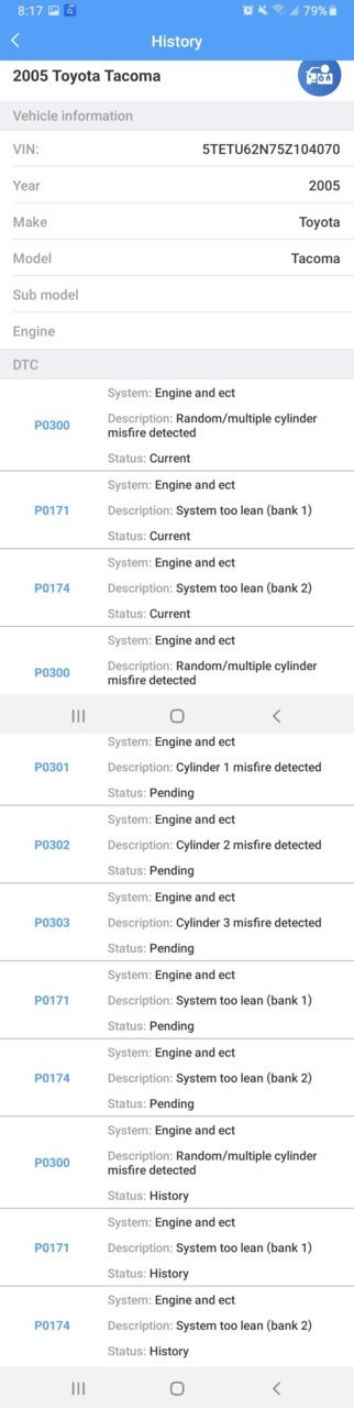

    The truck is still throwing p0171 and p0174 and P0300 (see attached file for Live Data Sheet and attached images for up to date diagnostics scan)

    Have the coolant checked for combustion gasses. If you were losing coolant, it was going somewhere.

    It more sounds like a warped head. You'll need to do a leak down test, or watch the cylinders while they are pressurized and use a borescope.
    The lean condition could be head related, or possibly a vacuum leak or a weak fuel pump. It's hard to say.

    The 05-06 V6 Taco head gaskets appear to have higher than average failure rates among the second gens. Many of the symptoms you describe fit a bad head gasket. Do a compression test and test the coolant for exhaust gases.

    +1 on that. Also do a cylinder leak down test and take a look at the fuel pressure. Failing fuel pump can cause those lean codes.

    I agree with everyone above about a problem in the head and/or head gasket.
    Two suggestions:
    1. Look on the underside of the oil filler cap. If you see something that looks like dirty milkshake, there's been coolant in the oil. Clean the cap, change the oil, and be on the lookout for new milkshake. If it appears, you still have coolant leaking into the oil.
    2. While the engine is cool, remove the radiator cap. Now start the engine and try covering and uncovering the radiator fill neck as the truck warms up to see if you can change the idle by doing it. If so, you have a coolant to intake, cylinder, or exhaust leak. I did that once to get a free head replacement including labor from a mechanic who had just replaced the head on my last Toyota truck. Obviously, don't burn yourself as the truck warms up. This test doesn't always work, but if you can alter the idle, you definitely have a problem.

    Unfortunately, it sounds like a head or head gasket issue. Compression test & coolant analysis like the previous posts have suggested.
