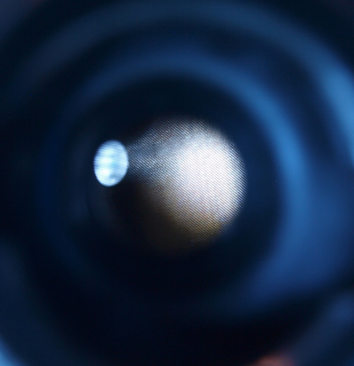

    Not a silly question at all. Yes, I did go through the motions of bleeding the system while the wheels were off the ground. Doing more research, I came across the reservoir clogged screen issue. Pulled mine off again and it was really clogged. Just cleaned it and a LOT of crud came out after multiple cleanings. Will reinstall and report back.

    Clogged screen was the problem. Perhaps the new pump and/or rack and pinion were unnecessary? Wish I had known about the possibility of clogged screen last week! :cookiemonster::cookiemonster:
    Power steering returns!!

    The crud in the reservoir was coming off in small sheets, and it took boiling it out on the stove with a commercial detergent to get it clean.
    It is not difficult to remove the reservoir from the 2.7 Liter 4 cylinder motor. Pop off the drive belt and PS pump pulley; remove three small bolts and pull the reservoir right off (after evacuating the fluid). There is a small O-ring that will need replacing. In hindsight, it is well worth doing! I did add a filter in the return line.
    Ounce of prevention versus 600 pounds of cure. :spending:
    Also reset the toe-in as per another thread here at Tacoma World. Worked a treat!
