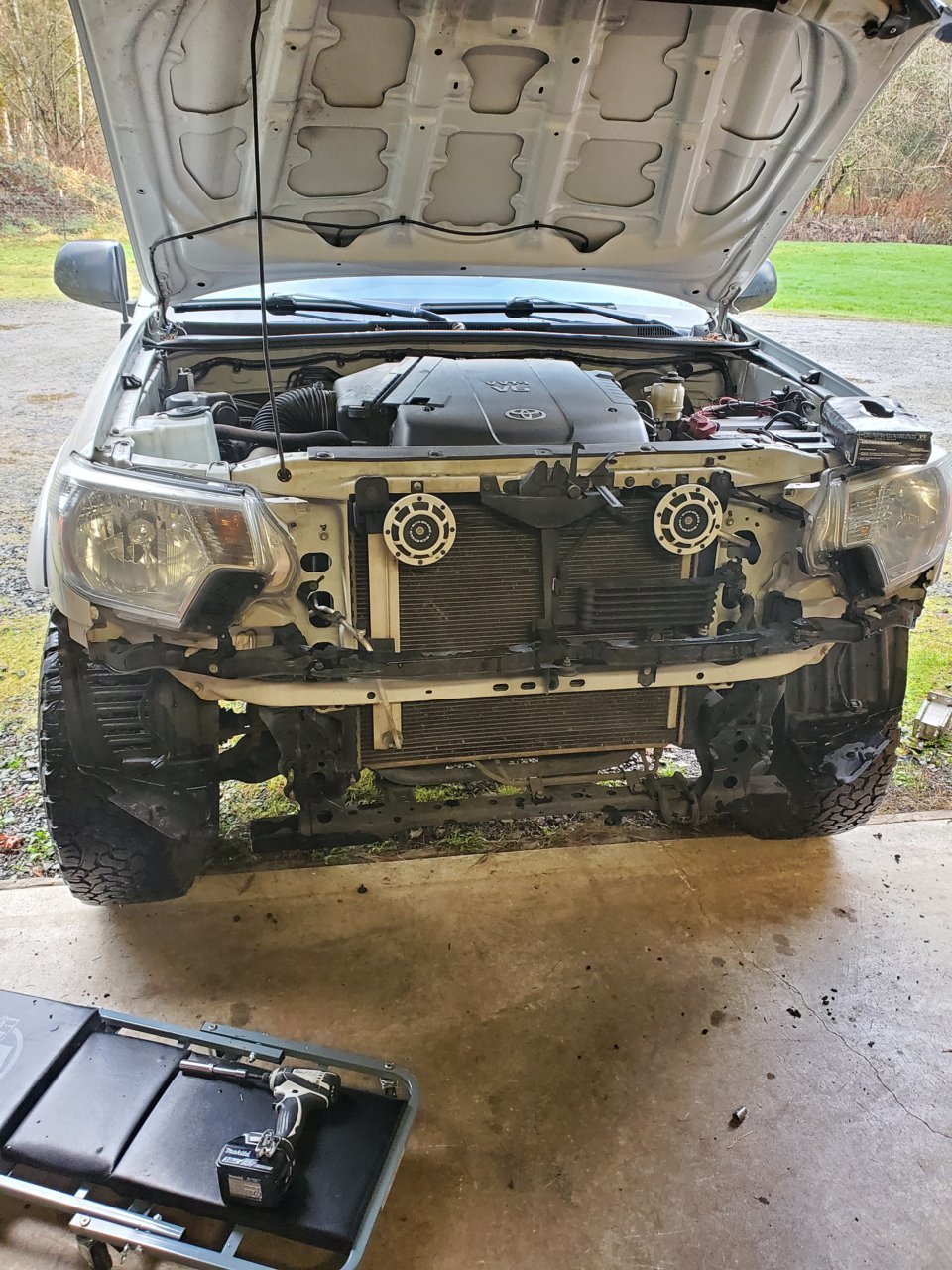

    If you have the '13 factory tow package there will be a small auxiliary trans cooler on the driver side just in front of the radiator. Doesn't hold a huge amount of fluid - but has a small amount of fluid in the cooler and lines. This is the '14.
