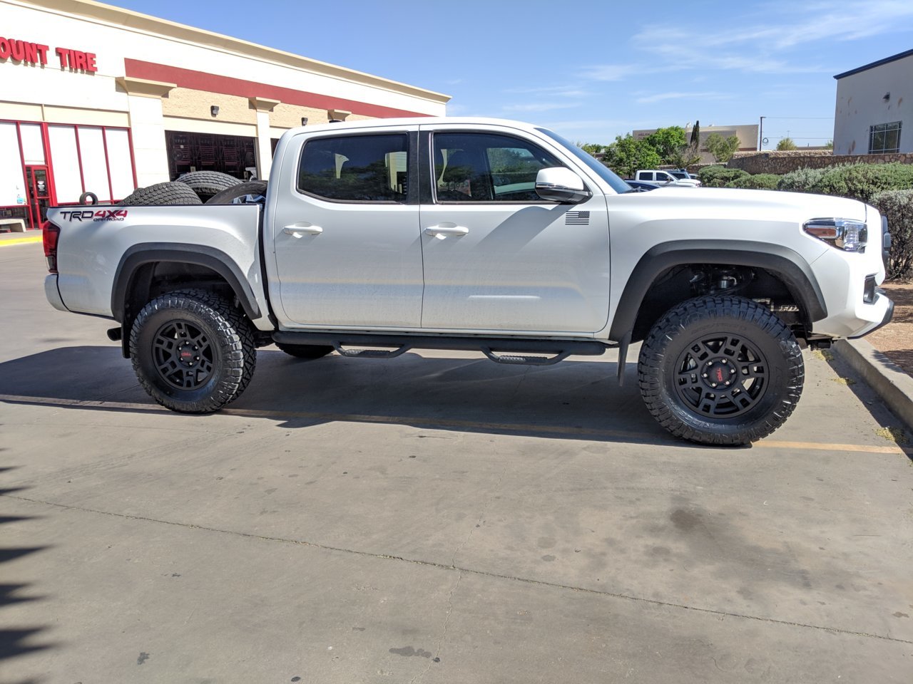

    Just got these 285/70r17 SL mounted. Will follow-up in a few weeks.
