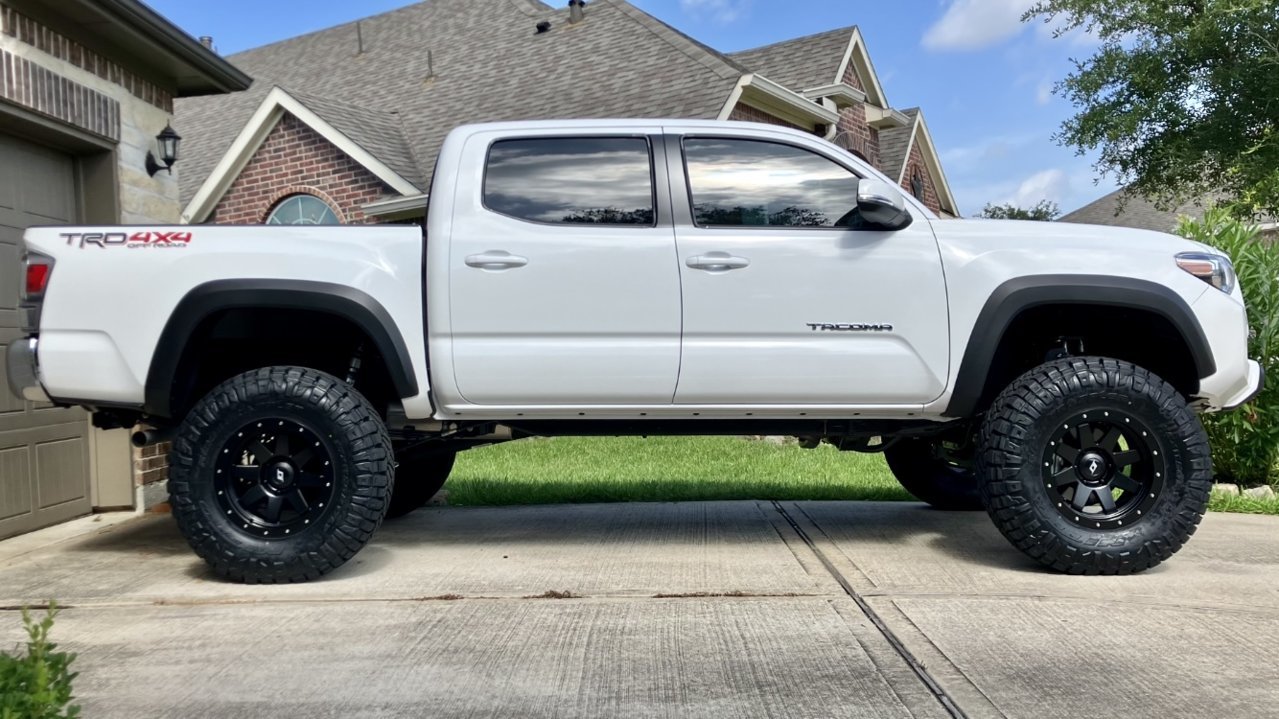

    Got the new 35/11.5R17 E load Nitto Ridge Ridge Grapplers installed yesterday, they replaced my 285/75R17 E load Hankook XT’s. I wanted something a little taller in the 11.5 wide selection.
    After going back and forth with DT on tire availability, I settled on the Ridge Grapplers, I’ve own two other sets of them and both were great.
    Had them installed and drove about 75 miles, steering wheel shakes fairly well at 40-60. Drove back to DT and explained the problem, had them road force balanced.
    Drove another 30 miles, then played with the tire pressure, steering wheel is still shaking between 40-60. Talking to them now about options, really wanted the 35/11.5/17, but might end up with 35/12.5/17’ s
    So the moral of this story, they look fantastic, but ride like crap between 40-60.

    40-60 mph steering shake is very likely balance.
    Keep pressing them to get it right.
    Chased similar issue on my 4Runner. Was horrible right at 60. If there are other DT locations near you, might try that. Could be the people, the machine, the tires, or combo causing it.
    Alignment can contribute but balance is main culprit.

    Ok, was told by asst mgr, two of the wheel’s measured out to 40+ lbs on the Hunter machine. He was able to get them in the high teens and low 20’s by breaking the tire free and spinning them.
    Traffic is crazy right now in H-town, I’ll hit the freeway perhaps this evening or tomorrow and report back.
    I am hopeful !

    Measurements to underside edge, pressure 32psi at, I’m not on flat ground.
    As a side not, the ride is much improved, ran it about 75 miles yesterday. Thanks to the Asst Mgr at DT in Pearland Tx.

    Well…back to DT, the Nitto’s are still vibrating, not nearly like before, but enough between 45-65 that it had to be addressed.
    They were able to get the 35/11.5/17’s Toyo AT3 in C load, not sure why they couldn’t before. DT has been professional and nice throughout this entire process, my favorite place to get tires.
    Don’t know what to say about the Nitto’s, my last two sets were perfect, this third set caused me four separate visits to DT and finally replacement.

    Riding much better now with the Toyo’s, steering wheel and vehicle no longer vibrates. After the last road force balance they were much better, but I could feel the entire truck rumbling, like riding on mud tires after 45 mph.
    Alignment was completed about 800 miles ago with the new lift, wheels & tires. The 34” Hankook’s drove straight and perfect, just wanted 35’s.
    I’ve ran three different set’s of 34’s over the years and never had issues, this is my first venture into 35’s.
    The lugs on the Nitto’s looked taller in some areas.
