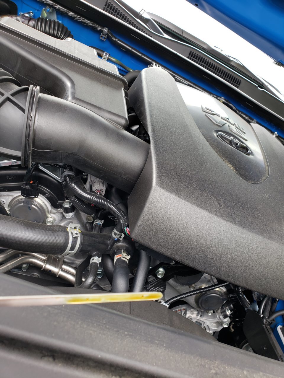

    2021 Tacoma V6 with 2600 miles on it, checked my oil level a couple times and it consistently reads about 1/4-3/8" over the max line(engine cold, truck sitting level). Do you guys think this is a major concern?
    I'm tempted to try and drain a bit out but I know that can turn into a real mess and I don't have any extra oil to refill if I remove to much20210523_142700.jpg

    Unless it really smells like gas, no issue. Those dipsticks are screwy and hard to read sometimes. My 2021 is the same way, even after I changed the oil myself around 4300 miles.

    Those dipsticks suck. You’re actually smearing the oil on the stick as you pull it out so it will appear to be too much. I went nuts the first time I changed my oil because I thought I overfilled it. Every time you check it will be at a different level depending on how you pulled it out. Don’t worry about it and just fixate on the shitty transmission like everyone else.

    A little steel wool or Brillo pad to scuff up the dip stick between the holes helps a ton.

    The only way to know is properly drain the oil, replace oil and filter with exact amount required. After running the motor, let sit on level ground for a bit, then check. See where it is on the dipstick.

    Try this. Leave it parked overnight. Check it the next day before starting engine. Might get a better reading.

    That's what I did the 3 times I've checked it. The back of the stick just smears the oil up about 4 inches and the front reads high.

    Check it warm, a few minutes after shutting it off. One side always smears, probably from a bend in the tube. Look at both sides and use the side that isn't smeared up.
