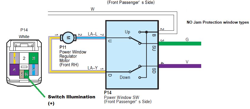

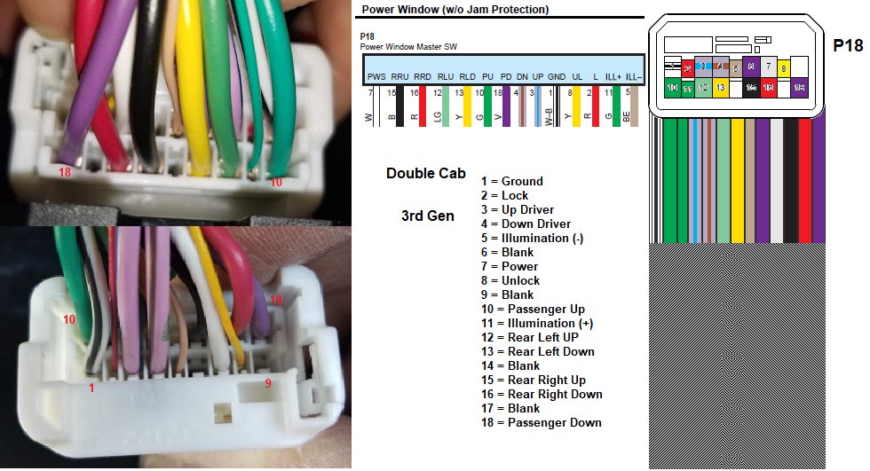

    For Running (TAILS/PARKING) circuit, you can posi-tap the connector (P18) on the Driver's side door control. It's a very thin gauge wire, don't use 3M type taps. It's in slot #10.
    Passenger side is also a very thin gauge wire.

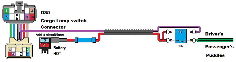

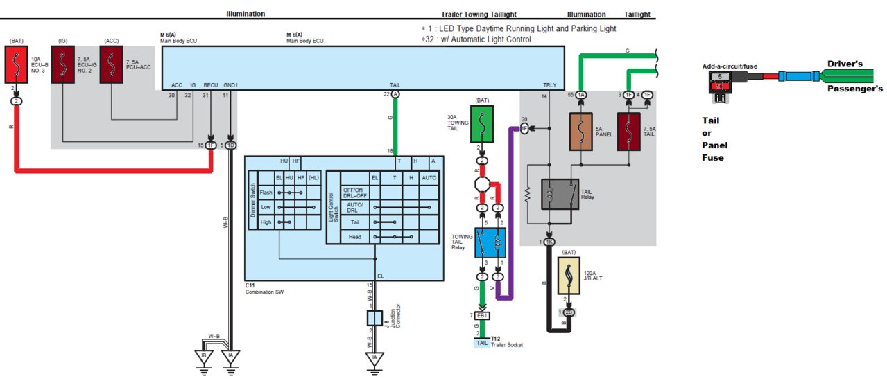

    Another choice, much easier (for Running Lights) if you like running wires from Cab to doors.
    whatstcp likes this.

    For the puddles, it won't be dimming type due to the shared ground. Your best bet install would be a duplicate of the Cargo Lamp circuit.
    Sliding Roof fuse is always "hot".
