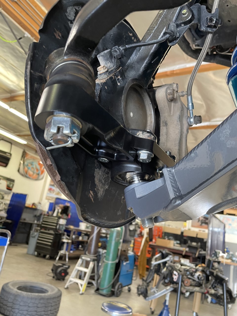

    any addtl pictures of this installed?

    They use a 100% stainless uniball and race. I have 30,000 miles on mine and they are still tight. Uniballs aren’t necessarily “serviceable”, you can drop a dry Teflon lube on the ball if it gets loud but they can’t be adjusted. That being said the uniball conversion gives you the ability to replace the uniball itself instead of buying a complete new ball joint, while also correcting the tie rod location/angle and the uniball cup angle. In my experience when you put a cap on a uniball it just traps stuff inside as debris and condensation come up from the bottom and corrode under the cap and are “out of site out of mind”. These aren’t for everyone but they can’t catastrophically fail like the ball joints do.
    This is spray painted, they are now cerakoted
