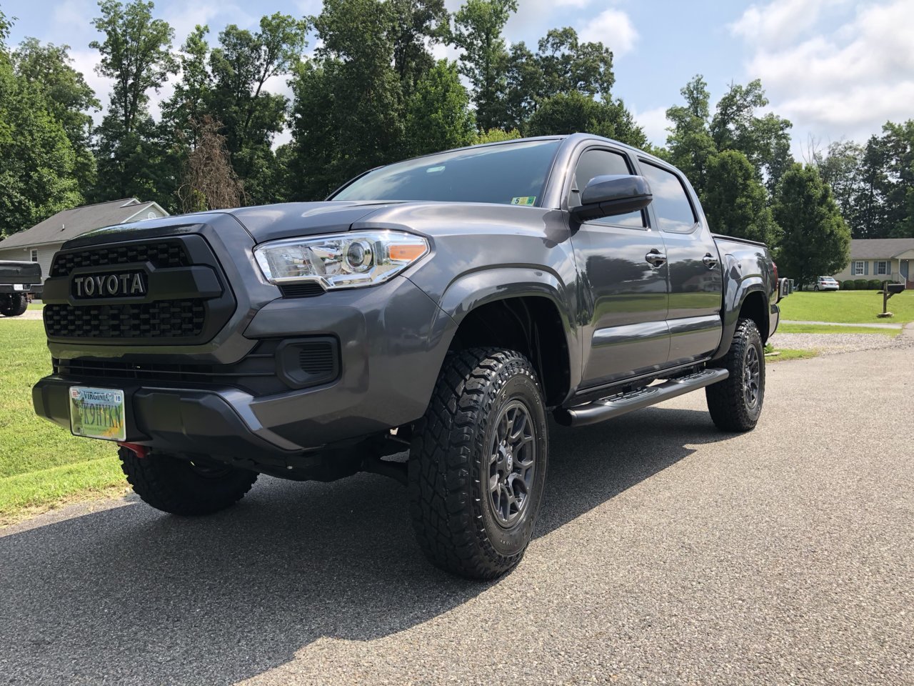

    Yesterday, I replaced the OEM 265/70R16 tires on my 2016 DCSB TRD-OR with LT235/85R16 Cooper ST Maxx. Discount Tire inflated them to 35 psi and I was on my way. First impression is that these tires feel just a bit firmer than my others. I also noticed a decrease is the truck’s tendency to follow the grooves in the pavement.
    Noise level was no worse than the Wranglers that came off. At 75 mph, I’m getting equal parts wind, engine and tire noise. Given the aggressive tread, I am very happy about this.
    It is too early to tell if fuel economy will take a hit but conventional wisdom says it will due to weight and tread design.
    Speaking of weight, I weighted the ST Maxx and it was 50.8 lbs. Cooper says 52 on their web site and Discount Tire claims 49. My biggest concern would be the degradation of acceleration and braking and how they would affect my trailer towing. I was pleasantly surprised in that I noticed only minimal change. Yea, I think I’m into the brakes just a little bit more to stop, but just a bit if any at all. I’ll be towing this weekend so I’ll have a more complete picture at that time.
    Appearance is a mixed bag. From the side the new tires look better. The slight increase in diameter and the aggressive tread and sidewall are nice improvements. However, from the ends, truck looks funny. The tires are noticeably narrow and give the truck an out of proportion look, especially with compared to the many Tacos that have oversize / wide tires on them. Had I chosen to go 255/85R16 I think things would look more balanced.
    Overall I am quite happy with my pizza cutter choice.
    Pics will come later tonight.

  6. Jun 15, 2018 at 5:24 PM
    n1as
    n1as [OP] Well-Known Member
    Apr 10, 2018
    #250049
    68
    2016 Tacoma DCSB TRD OR

  8. Jun 15, 2018 at 5:28 PM
    n1as
    Apr 10, 2018
    #250049
    68
    After:
    Farcedude likes this.
  9. Jun 15, 2018 at 5:29 PM
    n1as
    Apr 10, 2018
    #250049
    68
    The best way to compare them is to right-click and open the image in another tab. Then you can swap between browser tabs and rapidly see the difference. The two shots of the driver side are specifically edited to be the same size to show the difference more clearly.

    Guessing you’re on the stock suspension, with no rubbing?
  12. Jun 16, 2018 at 11:48 AM
    n1as
    Apr 10, 2018
    #250049
    68
    Yes, stock suspension. I have not fully flexed it yet but I am pretty confident the additional diameter will be offset by the reduced width to prevent rubbing. I may have a chance to flex it out this weekend. We'll see.
