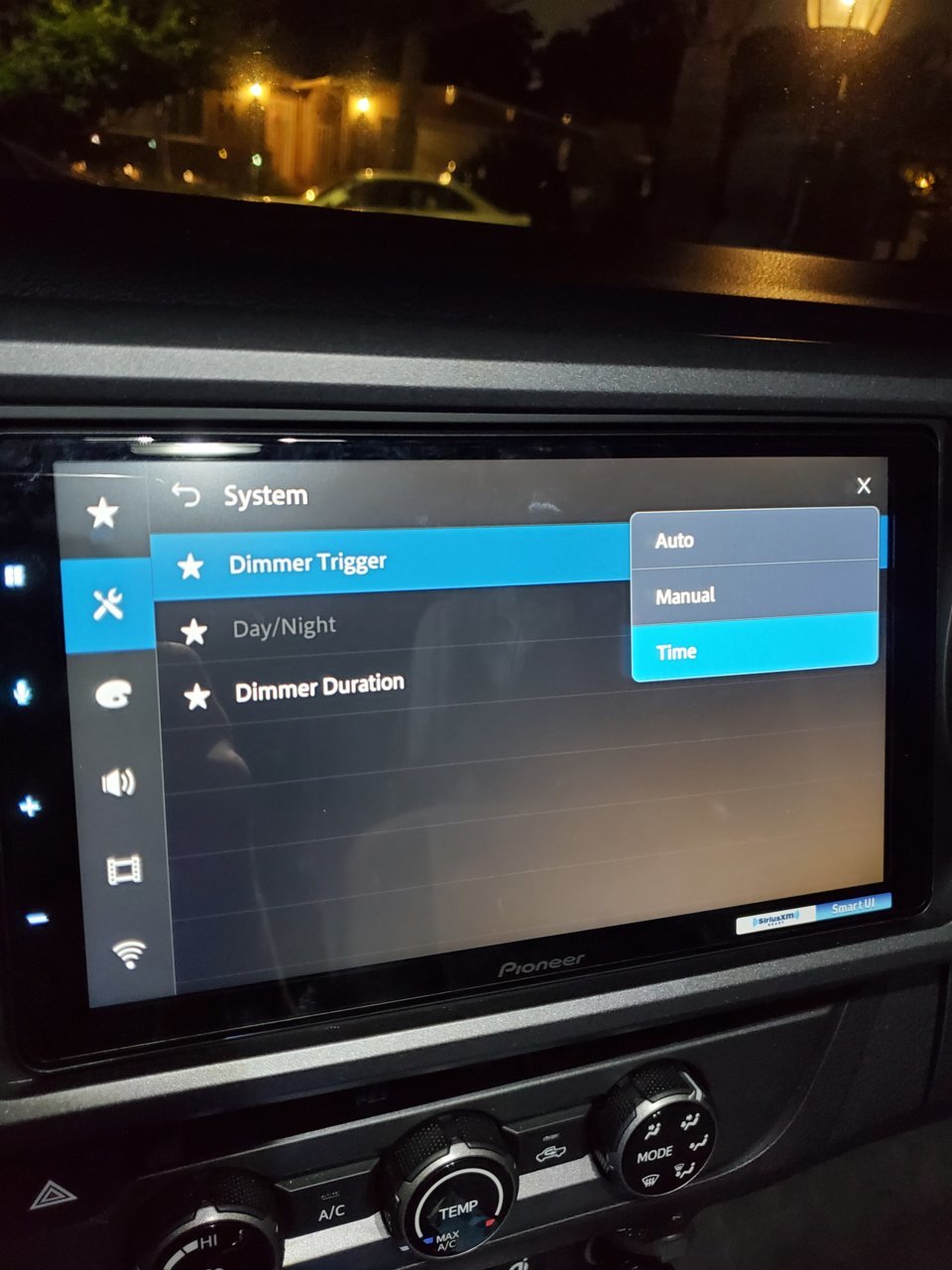

    Alright everything arrived today and I ended up installing the damn thing. All functions well, though I probably screwed something up with the auto dimmer light control.
    *edit
    Figured it out, forgot to connect the orange wire to the orange/white one. auto dimmer works perfectly now.
