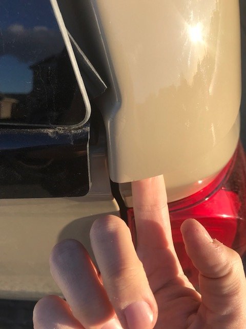

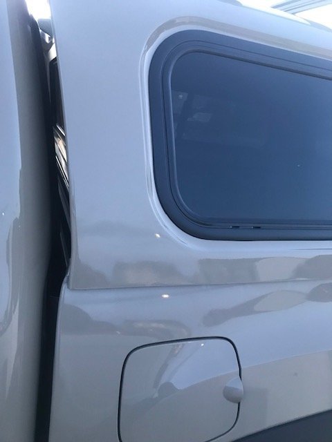

    I had a new Leer 100XR installed yesterday on my 2019 5' bed. The dealer did the install and he was highly recommended here locally. Initially it looked a little off to me, like it was sitting a bit far back on the bed. Got home and noticed it had already rubbed a little paint of the bed wall on the driver side near the cab.
    He said it should have a about a finger gap between bed wall/tail light and canopy, so that the hinged door gets a good seal with tail gate. I took his word for it but it just doesn't look like any other I've seen pictured. Photos below, what do you all think? This is my first tacoma and first canopy.IMG_5361.jpg IMG_5362.jpg IMG_5363.jpg IMG_5360.jpg IMG_5364.jpg 67124009770__9D73E5F4-7903-43C4-BEC1-56A97BBE8AB3.jpg

    I’ve never had a Leer or any other truck cap, but I have been extensively researching them and I recently ordered a cap from ARE. My cap hasn’t arrived yet but I can say that in all the research I did, including looking at caps in person, I’ve never seen one with that big a gap when it was installed on the correct truck.
    I fully admit I’m not an expert and I could very well be wrong! Just my 2 cents.

    Me neither, all the ones I have seen picture or in person are not set this far back, debating if I try to slide it forward myself or take back and ask him to do it.

    I have mine slide forward about an inch further than yours but I installed my own, but the ones I have had installed by a dealer (not on a Toyota) did not look like that.

    Incorrectly mounted. Dealer should be ashamed for 1. Not doing it right, and 2. lying about it being correct.
    Front of the cap should be flush with the bed front.

    I just went out and tried to line it up, if its flush with the bed front I can't get the passenger side latch on the canopy window/door to catch. So I backed it off about 1/4" from flush and it latched, then tightened it down.

    On my Leer 100xq, it was even with the front of the bed and close at the back. Definitely NOT a fingers worth of a gap, I couldn't even get my pinky in the gap. Who ever installed it was WRONG. The latches should be adjustable.

    MUCH better. Did they hook up the center brake light up properly? I'd take the tail lights out and check the connections and seal them properly [I'm betting they didn't] and make sure they put a grommet through the drilled hole so the wires don't rub and short out. Touch the paint up also where they drilled it.

    It was originally installed too far to the rear. When reinstalled, it's much better.
    I would add more clamps to keep it from sliding. On mine, I added 4 clamps -- 2 in the middle of the sides, and 2 on the front. (For the front clamps, you need to have a front accessory rail. One can be easily retrofitted.)
