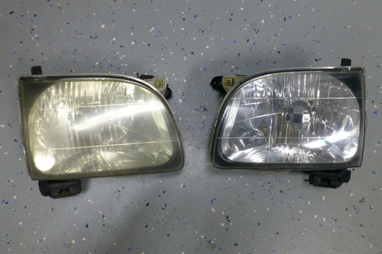

    My memory was jogged and I remembered that I had the original headlights stuffed in a box in the garage. The one on the left is how I found them. The RH one has been sanded and polished.
    Now what can I coat these with to extend their life?

    you can spray a urethane clear but make sure you prep it right before spraying. And dont use the rattle can clears but some automotive 2 part clear that requires a hardener. Good luck

    Unfortunately I don't have the background knowledge to do that, I wish I did. I was hoping for some rattlecan clear or some precut Clear Bra application or something.

    This is the stuff I have used and it's pretty much professional quality. You absolutely need to wear a respirator because this has isocyantes in it!!!!
    You do three coats, let it dry a few days then wet sand with 2k grit then with a compound polish. It will remove the orange peel and be clear as glass. Because it's a automotive grade clear coat, it will last as long as the clear on your paint but throw a 3m clear bra on it and it will most likely outlast the vehicle.

    OP if you use this make sure you follow the instructions and give it the recommended flash times between coats
