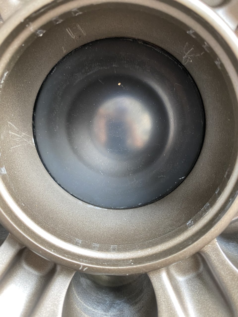

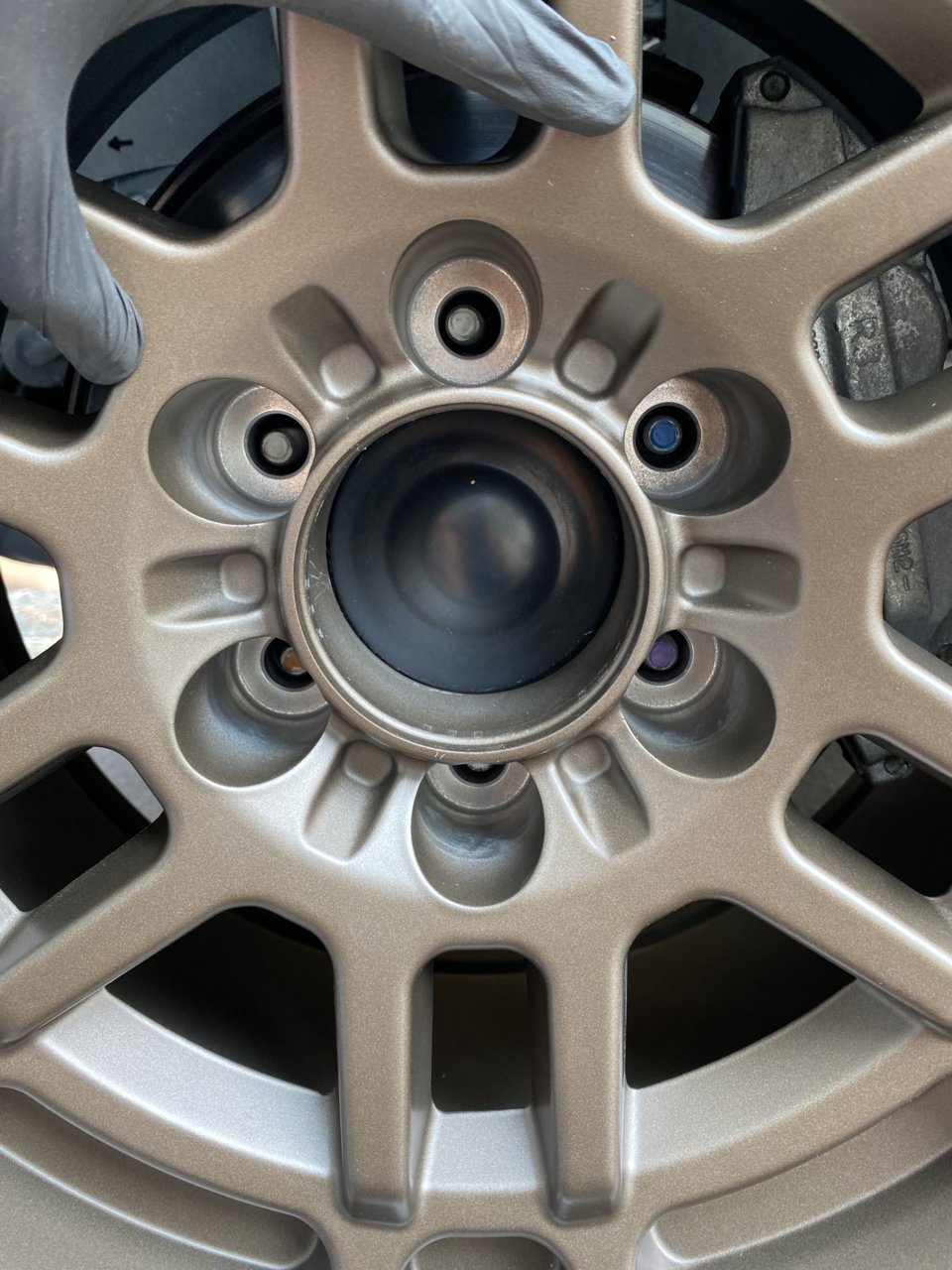

    Has anyone received FSW wheels lately and have issues?
    Just received an order today I placed for (4) of the F268 in bronze for my 2022 TRD Sport 4x4….Dustin had posted confirming all new wheels would fit (updated bore to clear dust cap) but I guess I received some old wheels?
    Disappointed is an understatement.

    Yes, I did reach out to them. Have not heard back. Posting photos asking if anyone else has this problem currently, is hardly putting them on blast. Especially when their site rep posted 3 months ago all new batches of wheels have 0 fitment issues.

    Thank you for letting me know. I replied to your direct message. This should not have happened. Please call in, as I instructed in my message, and we will get it taken care of one way or another.

    The wheels come with center caps? If so, the most expedient thing to do would be to run without the black dust caps. Spray some cosmoline around the axle nut if your area sees road salt.
    Do the wheels fit flush in the rear?

    Wheels fit in the rear. Front does not clear dust cap. Wheels do have center caps. Not removing the dust cap or modifying the truck, although removing the dust caps may work. I live in NY and the roads are salted heavily, I work for the DOT and have to drive in the snow + offroad on salt water beaches every weekend (for leisure).

    in a pinch i remember people saying they took some sand paper to the inside of the wheel hub and the outside of the bearing cover. Might be worth your time if so inclined to fix the issue yourself. My wheels F268 16x8 didnt have an issue. Bought shortly after they fixed the issue the first time.

    Thank you guys for participating in this thread. The wheels that we're purchased with the fitment issue we're not from an updated batch. We are actually out of stock, and that set was pulled from another location that had a couple of sets left. It was unfortunate that he received a set from the old batch, which had the issue with fitting over the dust caps on 4x4 models because the inside of the wheel hub bore was painted when it shouldn't have been. I was correct in saying that all future batches of these wheels will not have an issue. This was just a mishap that unfortunately happened after I stated that there we're no more fitment issues with this style. @BoomerGVNG will be taken care of, just as we have taken care of all our previous customers who had this issue.
    We will soon be restocking all of our styles, and this will no longer be an issue going forward. I apologize for the inconvenience, and any confusion this has caused.
