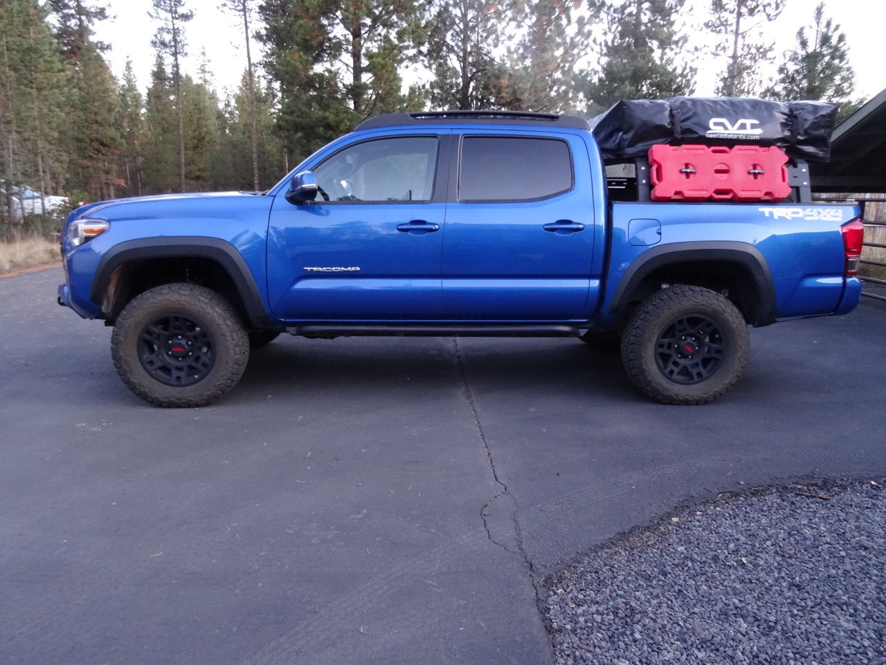

    Had the tires installed this morning and couldn't be happier. Looks much better than a 265/70/17 tire. A true 33" tire that isn't too skinny like a 255 and don't have to deal with a cab chop like you would have to do with a 285 tire. Seems like a perfect sized tire for these Tacoma's. And like the looks of this tire over the K02 as it is a little more aggressive. 1.jpg 2.jpg 3.jpg 4.jpg 5.jpg 6.jpg DSC02565.jpg

    Have only driven them home from the tire shop which is about 20 miles away. Was doing about 70 on the highway and noticed just a very slight increase in noise over the KO2 tires. Not bad at all and better than the DuraTrac's I previously had. Would not recommend those to anyone as they get really loud as they wear.

    Those look awesome!
    Lots of siping, I bet they do well in rain/snow/ice.

    That looks great! What is your setup (Lift, UCA, rims, etc.)? Does it rub at all?
    Thanks!

    Currently running OME BP51's in the rear with the HeadStrong 3 leaf and the overloads left in. The fronts are the 6112 (6/5 clips) with the 650lb springs. Running stock UCA's but have the Icon Deltas and the OME BP51 front coilovers sitting in the garage (just haven't had time to install them). Before I put these tires on it had about 2.25" of lift in the front. Just checked and looks like I have just over 1" of clearance at the cab mounts on both sides when fully locked. And the rims are the factory Pro 17x7 which is another reason I love this tire. Made to fit a 7" rim which most 285's aren't.
