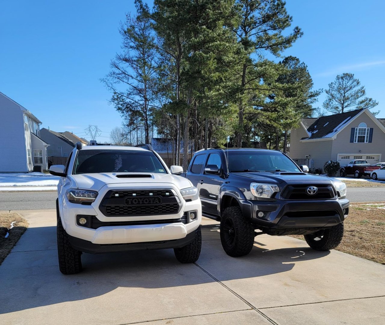

    Hey everyone.
    Recently picked up a 2012 TRD Sport DCSB frame is damn near perfect I don't see anything wrong with it. Got it with 131000 miles for about $16k out the door. Has the JBL system. Some things were already done to it. It's a mall crawler, fishing and hauling whatever kind of truck. But has a 3 inch lift nothing special just a spacer lift. 33's nitto trail grapplers I think with some XD Wheels (Not sure if I like them yet). Rough country rear shocks. A bac flip 2 tonneau cover (can't stand that POS). Had Power step bars which I took off because it's dumb, and went with stock step bars for now. Previous owner also did all LEDs in the cab so that's nice. Also has a K&N CAI But that's about it.
    Things I've done in the 2 months of having it:
    1. Fixing bump steer/vibes.
    Installed new Rough country UCA's, new tie rods, new sway bar links, new sway bar bushings, and did the carrier support bearing. I rotated the tires, Went and had an alignment done, and balancing and still getting an odd "front end about to fall off" when I hit bumps. Not quite sure what else to try next. New tires maybe?
    Update 14May2022: found a loose intermediate shaft so this will be the next fix.
    2. Cosmetics.
    Installed sequential mirror lights, 3rd gen step bars, previous owner had a light bar wiring harness so I just got 2 El Cheapo light pods in the lower grill nothing special just so I can see night fishing or whatever lol also put a switch in for the light bars. Short antenna, AC Knobs. Replaced all door speakers and tweeters, Sub will be next. Switched out the 3rd brake light with a blacked out LED one. Have LED head light and fog light bulbs.
    Update 14May2022: installed sequential mirror blinkers from Amazon for $50
    3. More Cosmetics.
    Painted trim pieces with "Duplicolor trim and bumper" spray paint to fix the annoying fading. Has held up really good so far. Time will tell. Repainted the tonneau cover with Rust-Oleum truck bed coating due to fading and looking like trash. Kinda polished the head lights. Either want to redo it or get blacked out headlights not sure yet. Did a quick buff, polish and ceramic wax.
    Things I need to do coming up.
    All fluids flushed, tune up, wants to do drilled and slotted rotors up front. Blacked out windows possibly an upgraded head unit. Maybe more but need to knock out maintenance first lol. 20220420_120959.jpg 20220420_120951.jpg

    Nice truck

    Oh look, another mod....
    That's a sharp looking truck!

    Welcome aboard, and nice truck!

    getting rid of the spacer lift might cure the front end issue.
    Sounds like you've been busy since you got it. Lookin' good so far.

    Dump the spacer lift and throw some 5100's in there. I bet the bump goes away after that.
    Also, my vote is you get rid of those wheels lol. Regardless, great looking truck :cool:

    Nice truck. I’d like to see the alignment numbers, especially the caster setting.
